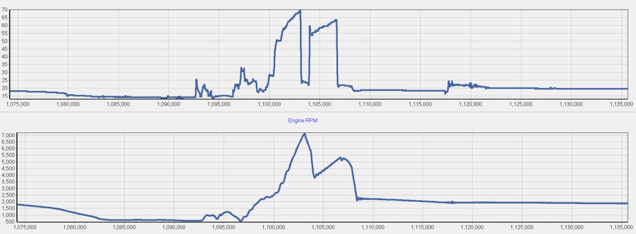

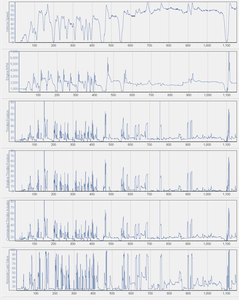

    I did a new log today with a lot of different full pedal runs.
    I did manage to get some full throttle, but it was strange to say the least.
    here is the overall picture (obviously all of these are not full throttle, but a bunch were, just try to match up the absolute load values)

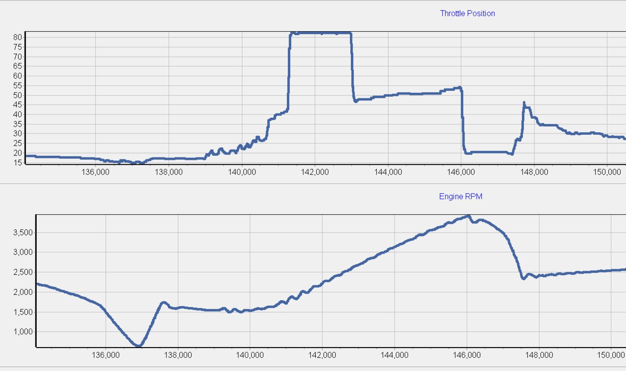

    now here are the close ups after trimming the CSV in VF.
    1st gear shifted to second gear without going full throttle
    As you can see it hit full throttle at first, then as the rpms rose it lowered automatically to around 45-55
    here is a full throttle run in 3rd gear from a low rpm
    Same, went full throttle, then went back down, i never lifted, look at the rpms, it dropped at around the same number

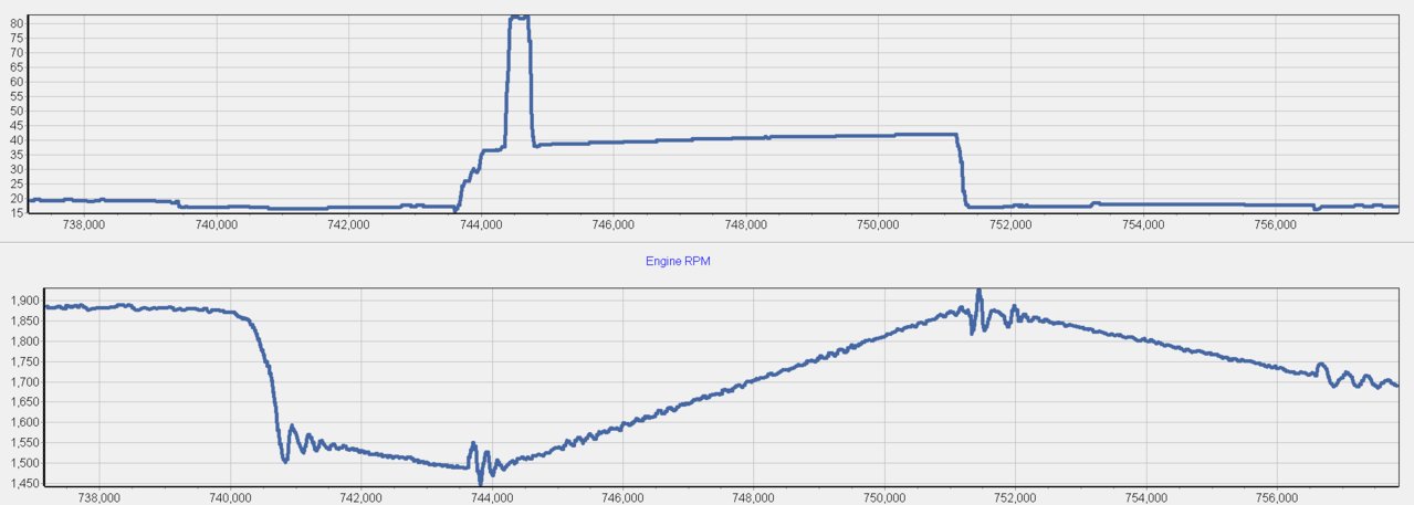

    Here is a first full to second full throttle
    This time i revved to 7k in first and it never hit full throttle in either, but it didnt do that weird drop off.
    The only difference between the first 2 pictures and the last one, i turned off traction control for the last one.
    weeeeiiiiiird.
    Its probably my fault, i may have done this to myself. maybe not though. Still would be interesting to know

    This is torque control going on.
    Find the map "engine torque Nm"
    Raise the values until you get full throttle
