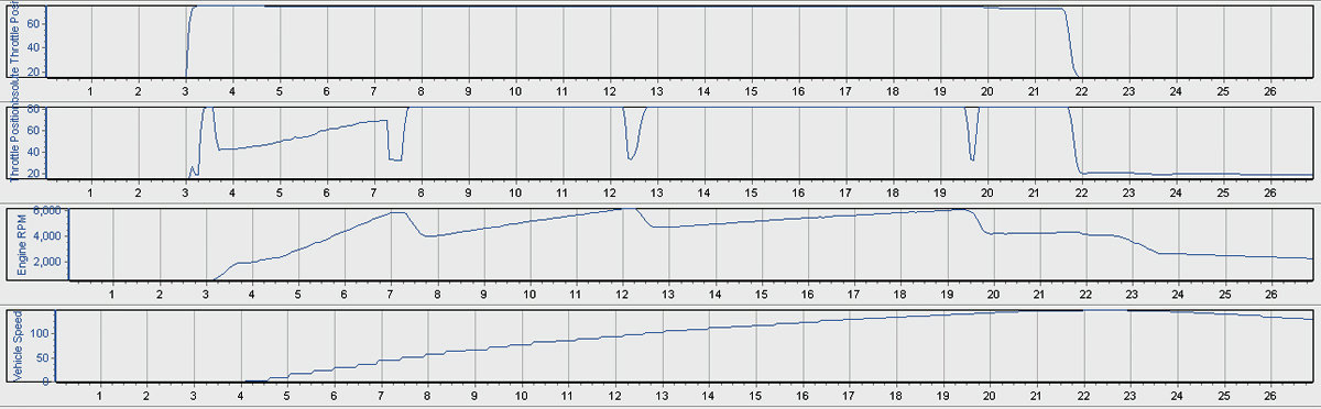

    My Tacoma is a 04A61 A/T. I have done way more with vF Tuner than I have posted. I am vF Tuner'd Out. Got to take a break from it. All of the changes that I have made and my Tacoma still won't take off at Full Throttle (>80° Throttle Blade Angle) in 1st Gear or any thing remotely close to Full Throttle in 1st Gear. My Tacoma takes off so lazy, it's pathetic. I will likely play with vF Tuner again when Mat @OVTune releases 2.0 Final Performance/Gearlock. If this final tune release does not allow Full Throttle take offs in 1st Gear, I will be seriously bummed out.
    For those of you still enjoying playing with vF Tuner, more power to you. If anyone figures out how to get these A/T's to take off from a stop at Full Throttle, please PM me. :thumbsup:

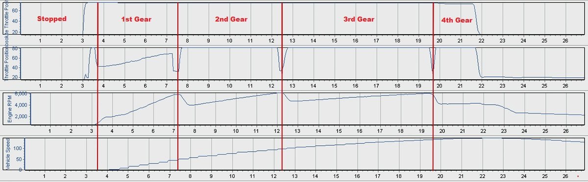

    My truck definitely responds to aggressive tip in tunes, but it does not affect my my Full Throttle Pedal take offs. There is nothing wrong with my fuel pump. The throttle blades just wont open all of the way in 1st Gear.
    Line 1 = Accelerator Pedal (pedal to the floor, 1st gear take off @ 3 seconds)
    Line 2 = Throttle Blade Angle (4 seconds to 7 second goes from about 50% to 70%)
    Line 3 = Engine RPM
    Line 4 = Vehicle Speed
    Same Graph with added info.
