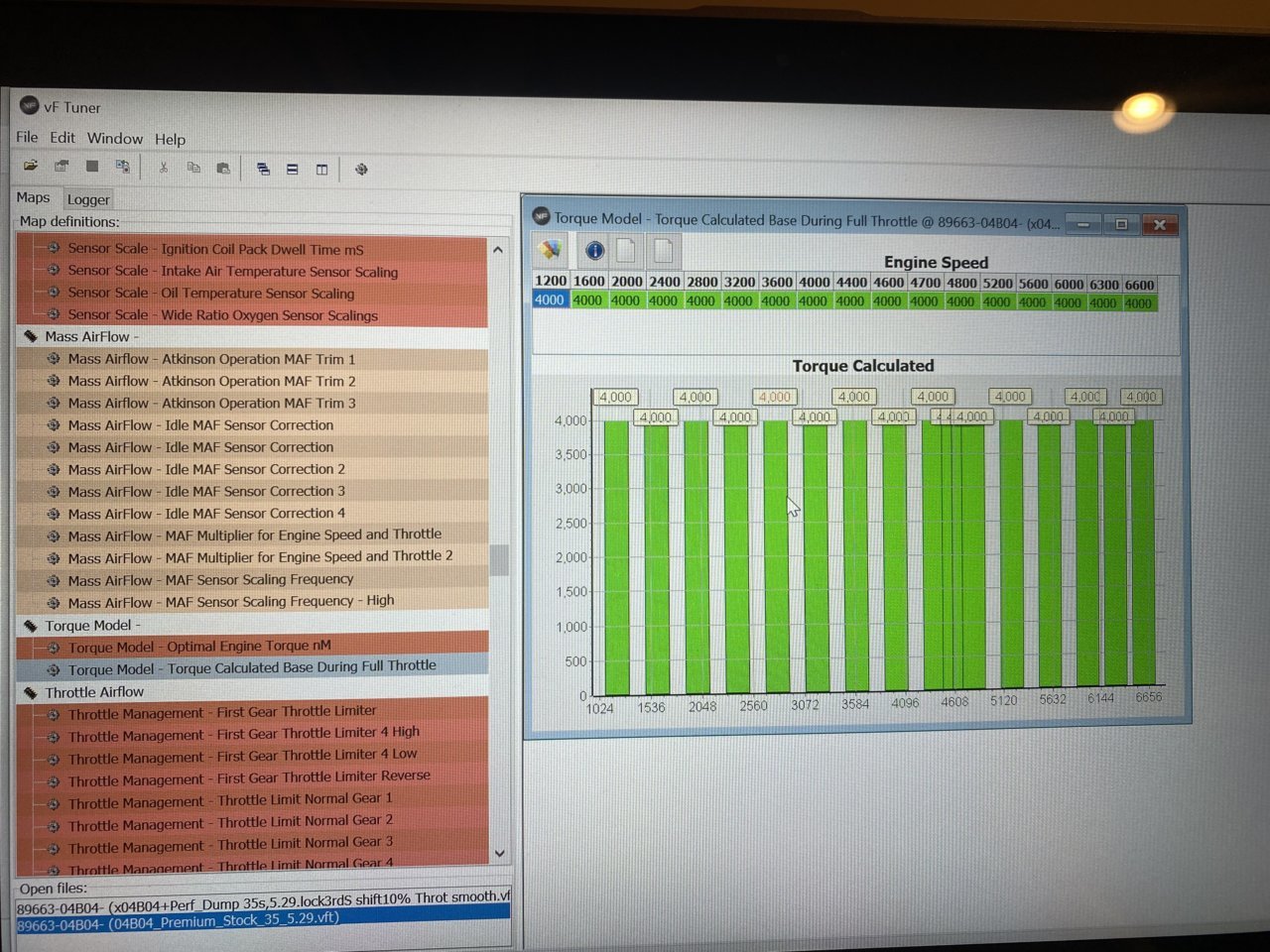

    Can someone please post a screenshot of this map?

    Currently in a ground blind, awaiting Bambi's older / hotter sister. Wanted to see if looking at this, if I could make any sense of Mat's suggestions.

    Nice sounds fun lol and you can adjust higher then the (4000) not 100% sure how high to go, will try 4200 and see what happens ha. Also what was it to start? Should be fun!

    Has anyone messed with this yet? I found the map he's talking about but I'm not sure what he means by "the map should be flat 4000"." I guess for "raise the values until you get full throttle" I can just do a multiplier on the table and see how it goes.

    I am playing with it now I think he meant raise the 4000 tell you get 100% throttle. Also do you have to be driving to log the throttle or can the truck just be off with the Ignition on?
