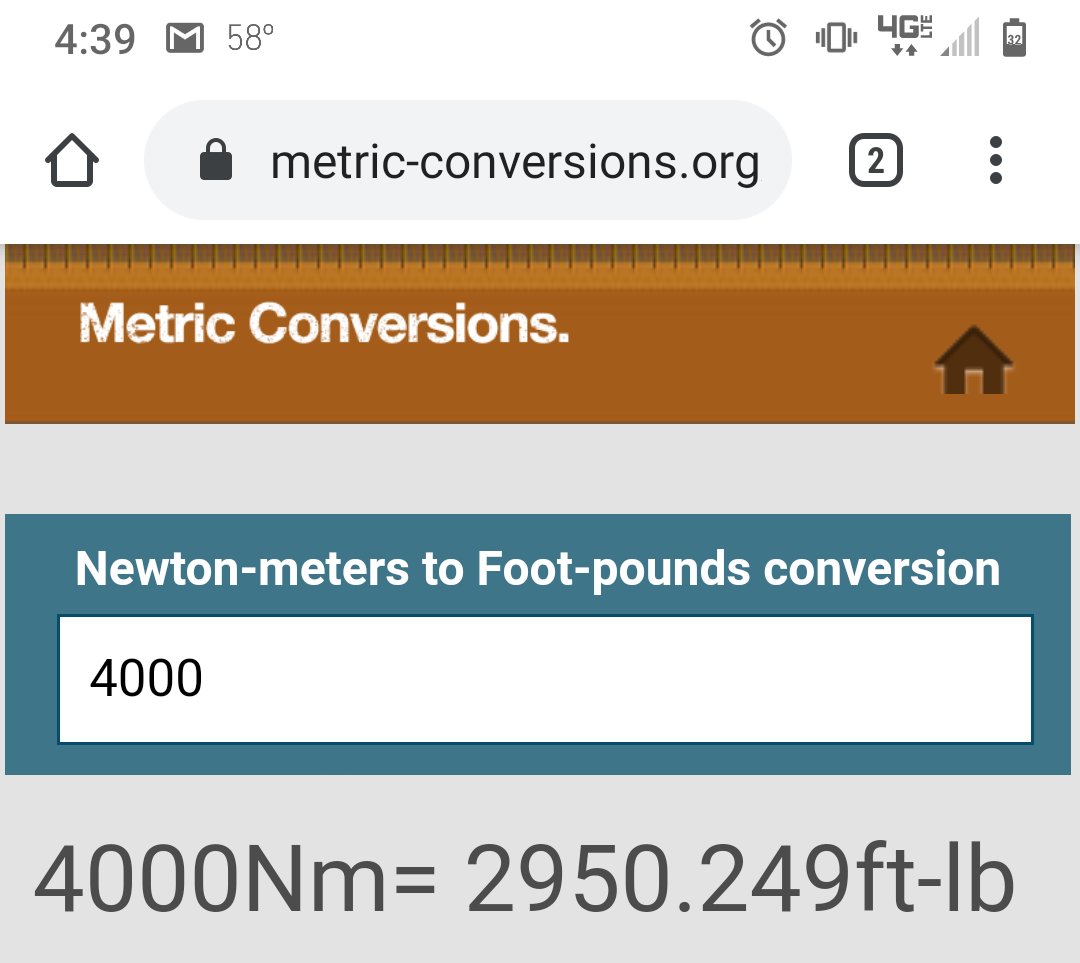

    Well... This picture won't help any! LOL.
    Mat said the throttle is being limited by torque. Double the values? It's not like it can create this much. o_OScreenshot_20201010-163909.jpg

    Techstream will log throttle w/out truck running... So I would think so. But will truck register the changes to the calculations, probably not... I wouldn't think it'll be able to complete the calculations without a load on the engine.

    I raised it to 5000 but did not find that it fixed my issue.
    Another MT guy made his 4900
    I did however make the Throttle request to airload linear like some of the guys have posted in here in addition to changing that map to 5k and now i have the ability to go full throttle whenever i want to.

    So the combination of these two things worked? I thought OV said this would address Automatics, MT was another fix???

    First off, what a dang coincidence. I post this and you two were already talking about it.
    2nd: Ugh, now I know what he means. I was looking at the original table (nM) he mentioned before he reposted. Duh.
    I see flat 4000 now! lmao
