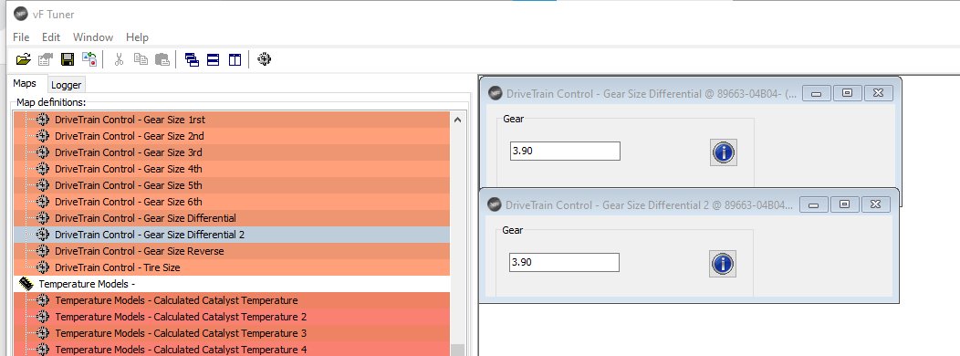

    easier to just post and share!

    Dixon, Mo
    2019 Cavalry Blue Tacoma TRD OR (sold) 05 Duramax
    I need to make sure mine are set to 5.29

    strangely enough when I initially flashed the newest version I got the dreaded "failed" screen with the rest of the oh shit information. I pressed try again and this time it took! Not sure what caused it - maybe battery/voltage spike or drop. Started up so all is good. Odd and down right scary. Think I will download the new VFT version released this week and take a break from flashing tunes for a while - just going to MooseDitty's most recent regular octane performance tune (10-10-2020).
    EDIT: NOTE TO OTHERS - CHECK TO BE SURE YOU ARE CONNECTED TO YOUR 2.0 USB CONNECTION ON THE COMPUTER AND NOT THE 3.0 USB CONNECTION. I WAS CONNECTED TO THE 3.0 AND AFTER SWITCHING TO THE 2.0 I HAD NO ISSUES.

    just remember to leave the "gear size reverse" as-is - do not change this one.
