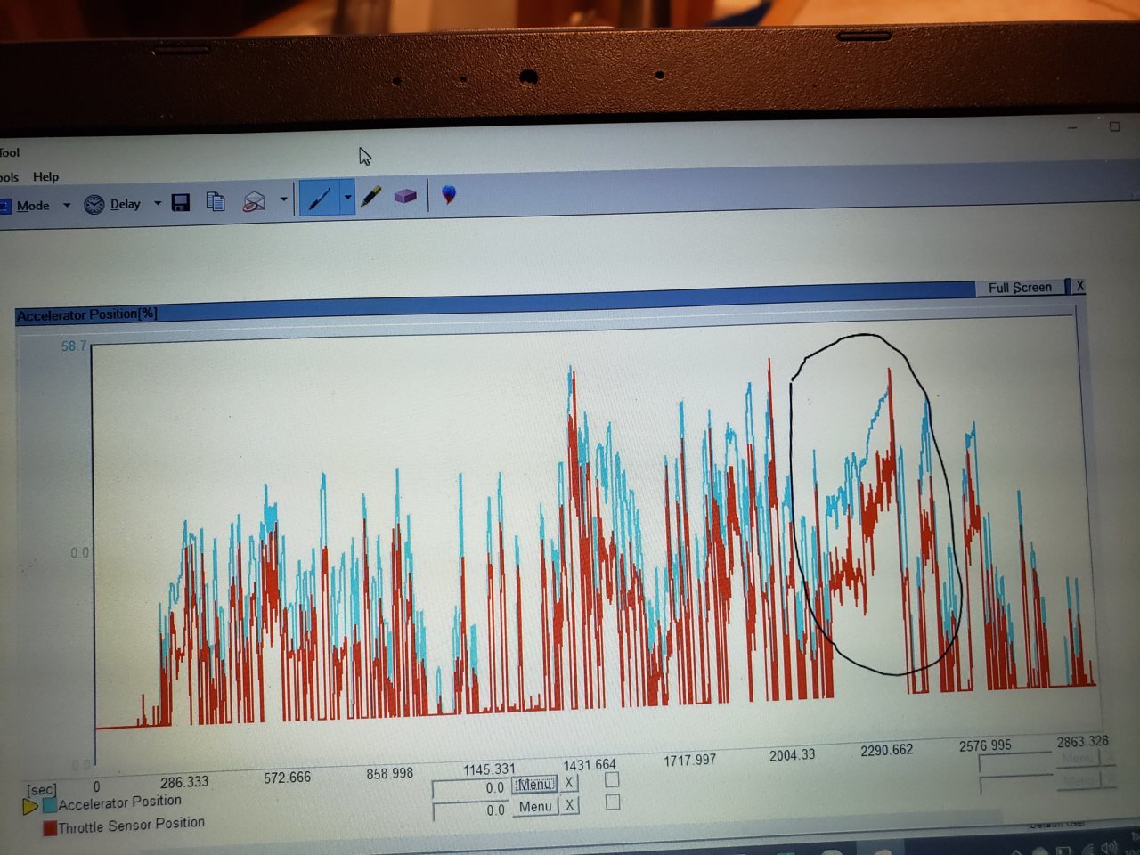

    Here is what i see on latest iteration.
    I circled the area where the engine load was 85-90%, accelerator climbing 45 to 52, but throttle sensor position is behind by 10 or more points. Sort of catch up when ACIS kicked in.
    Similar with throttle position°.
    Per throttle limits for gear 5 I should be matching the accelerator.

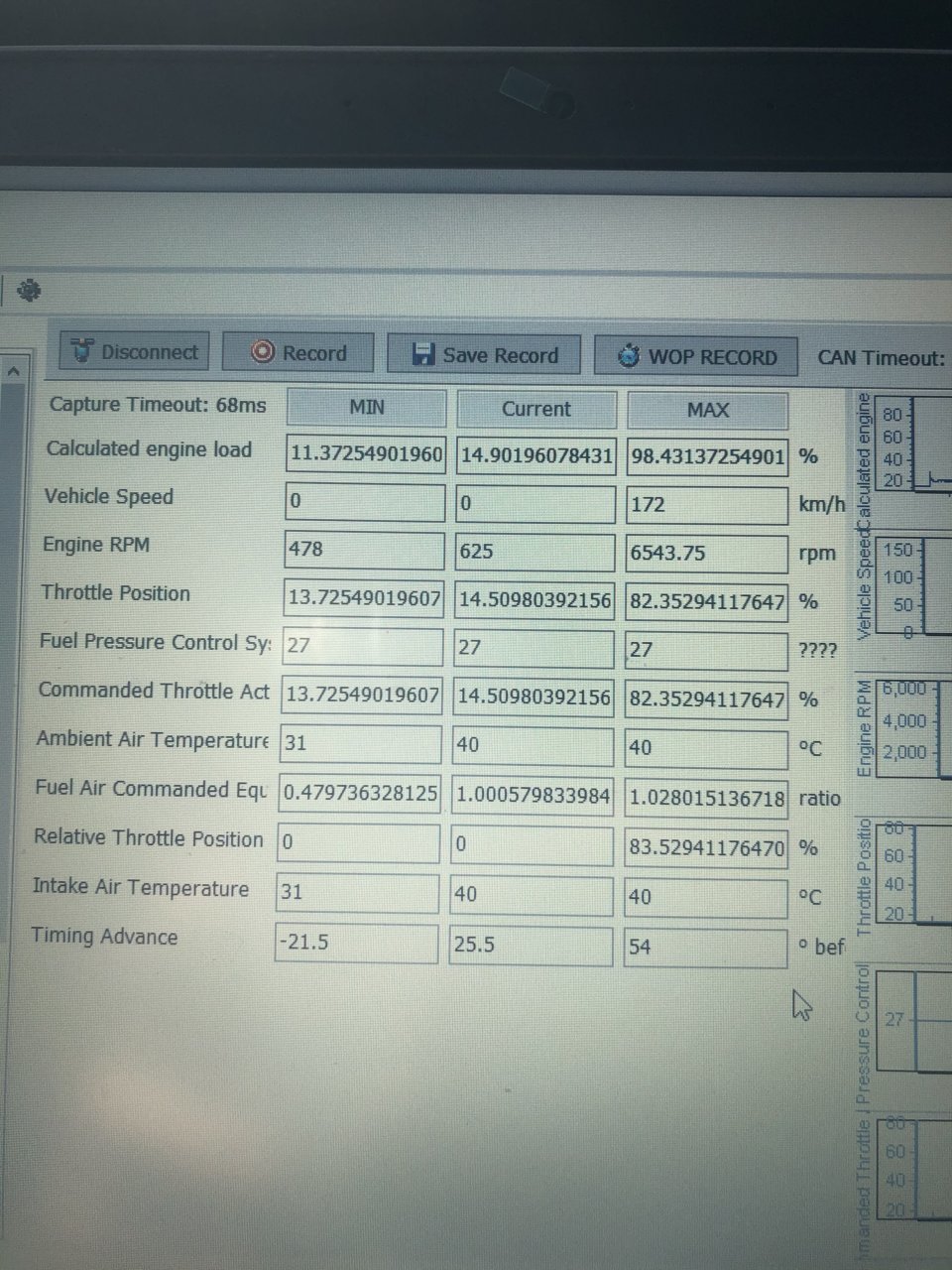

    Tune: Nexus +P Add ons: +3" custom suspension 295/70/18 Yokohama M/T Tires KMC XD Grenade OR wheels KN intake Blackhawk MBRP Exhaust TJM Rock Crawler Bumper Lighting (+10 H.P.)
    I
    I'm totally down for learning something!
    When these values do align, what are the benfits? How do you decide and or know which tables should align? This particular example attached was from my latest tune? What would you suggest I do to it to improve upon it for this particular example? I'm definitely interested in your knowledge / thoughts / logic. If what you say makes sense in my simple head, I'll give them a go and see what the AssDyno5000 (Binford Model) has to say. :D

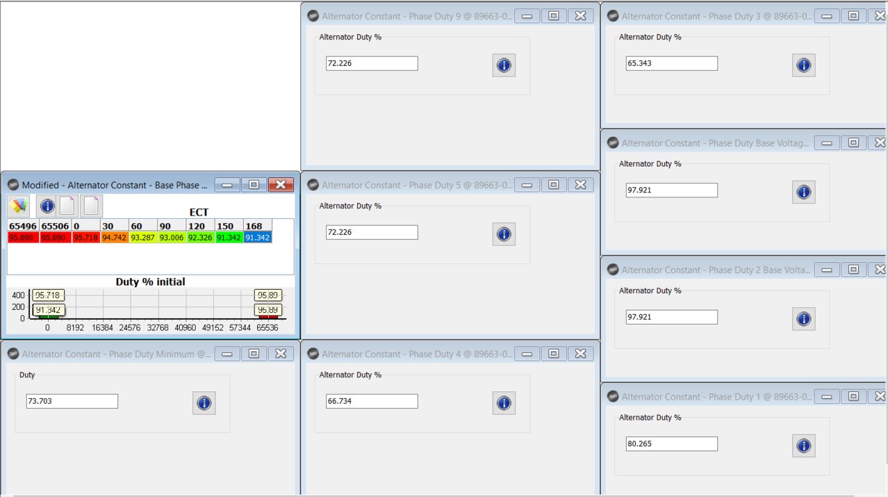

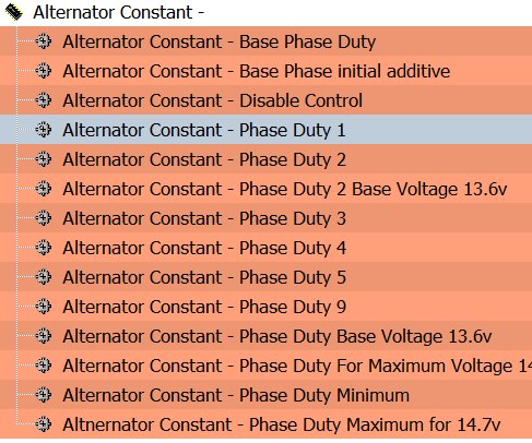

  20. Oct 11, 2020 at 3:02 PM
    #6380
    banjoist13
    banjoist13 Well-Known Member
    Sep 5, 2016
    #196465
    74
    Ian
    Humboldt County, CA
    2016 Off-Road 4x4 Manual Transmission
    BAMF Alumisteel front bumper, BAMF dual swing high clearance rear bumper, RCI full skids, C4 Fab Rock Sliders, Rago Fab LCA skids & rear shock mount skids, Method Trail 701 Wheels, ARB dual onboard air system under hood, Taco Tunes speaker system, Rago fabs center consol MOLLE, Weboost Drive Sleek OTR, SDHQ Billet Battery Terminals, Gofast Camper, Morimoto XD headlights and taillights, Accutune custom tuned Fox 2.5 adjustable front w/650lb Eibach springs and rear shocks, Deavers stage 3 leaf springs, Martin off-road camper rack, Cammo & Covers Tactical Seat covers,
    Hey y'all! sorry for the delay, work has been a bit crazy lately and I can only test the cold start voltage in the morning.
    Here is my newest iteration of numbers. The starting ECU voltage is ~14.56v-14.6v which is around 14.7v at the battery when the engine is cold in the morning, currently our mornings in Nor Cal are at around 50-60 degrees. Once the engine temp comes up to around 140 degrees the voltage will drop down to about 14.3-14.4v which is within the recommended minimum charging voltage from Odyssey. Currently, my battery is topping off just fine. I am still trying to get more info on what each duty cycle does and what the percentages are in relation to very specifically, i.e. what exact voltage are they related to and do they relate to charging vs float charging. I am coming to realize that each vehicle's alternator and such works a just a bit differently so y'all will need to optimize based on your specific vehicle. Send me your numbers if something is off a bit and I will help you adjust.
