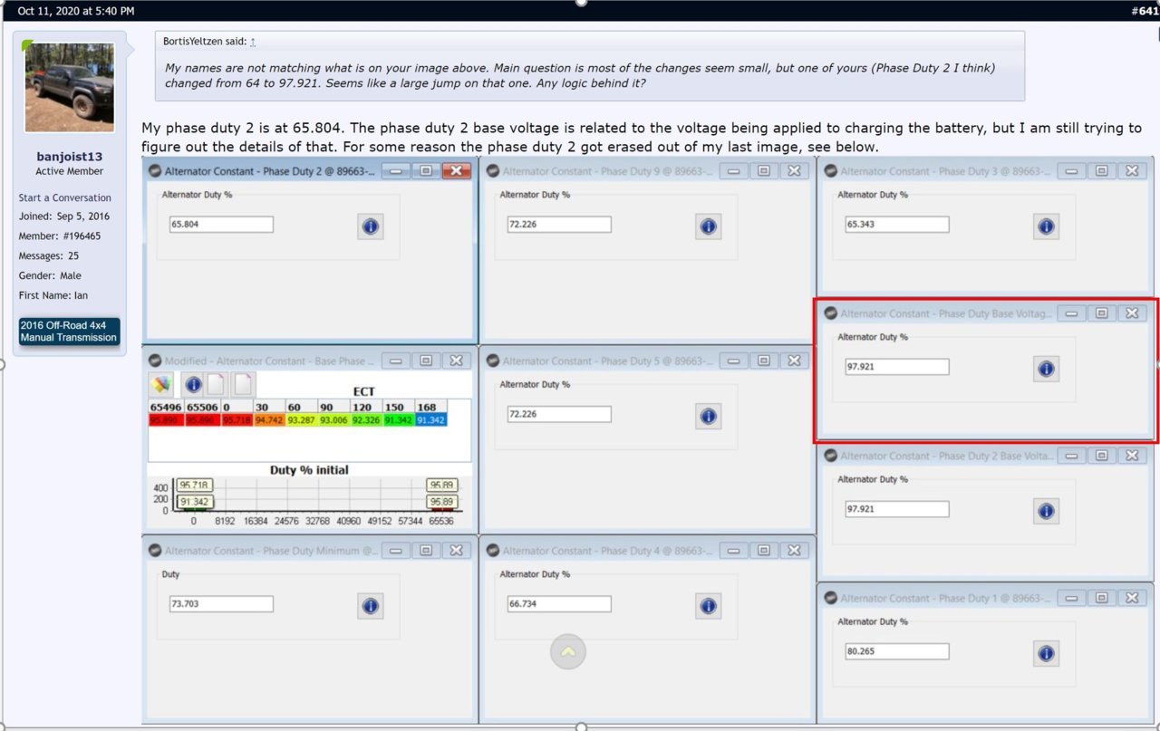

    My phase duty 2 is at 65.804 still and I haven't changed it yet. Other phase duties were renamed. I need more info on what that actually does. The phase duty 2 base voltage is related to the voltage being applied to charging the battery, but I am still trying to figure out the details of that. For some reason the phase duty 2 got erased out of my last image, see below.

    Which map is this in red?

    That chart deals with voltage output vs engine temp. It seems to be the most important one so far until I figure out the charging voltage vs float charging and how the phase duties relate to that. As the temps in the engine bay increase the ability for the battery to receive charge goes down. This is why high-end electronics have massive cooling capabilities as colder temps increase the efficiency of voltage transfer. The percentages in red deal with maximum voltage output when the engine is cold, i.e the voltage maximums applied when first starting the engine in the morning or after sitting for hours in cold weather. These values will give a maximum output of just under 14.7v at the battery terminal at around 57-65 degrees outside ambient temp on a cold start. Our alternators pump up the voltage to quickly replace the charge used to start the vehicle and then drop down to a lower voltage within about 3-5 minutes as the engine temp rises as not to damage the battery. I have been tuning to try and stay within acceptable values of AGM batteries at any given temp.
