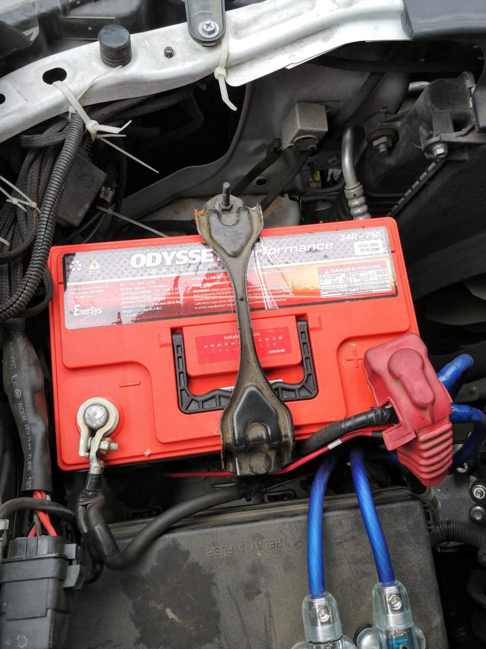

    hey Mat, any news on this? not seeing these tables in 1.2.6.0. waiting on these tables to install the catted tubes, been sitting in my garage since exchanging for the uncatted tubes with you last year. :)
  18. Oct 11, 2020 at 10:58 PM
    #6438
    Shellshock
    Nov 21, 2015
    #170338
    23,442
    Iowa
    mZiggy and Tac0Tic0 like this.
  19. Oct 11, 2020 at 11:09 PM
    #6439
    su.b.rat
    su.b.rat broken truck
    Jul 30, 2016
    #193316
    9,869
    thanks for the update. i'm also on an Odyssey group 34.
    b3itz likes this.
  20. Oct 11, 2020 at 11:12 PM
    #6440
    su.b.rat
    Jul 30, 2016
    #193316
    9,869
    i saw those, they were set to zero by default. i was expecting something expressly labeled "dump tube.." but i guess he was referring to the whole .vft filename. Shellshock are you 100% on this? i want to finally install them next week but only if i'm certain i can handle any code. asking because the bytes are defaulted to zero which i wouldn't expect.
    anyone successfully cleared a dump tube related code with these byte settings?
