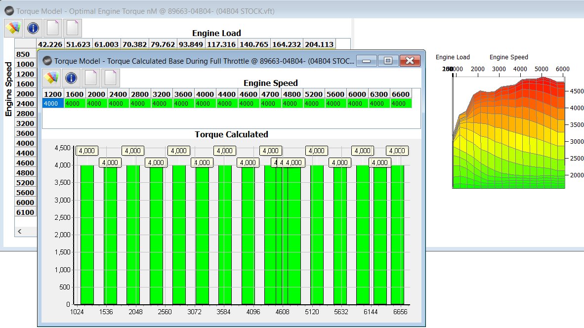

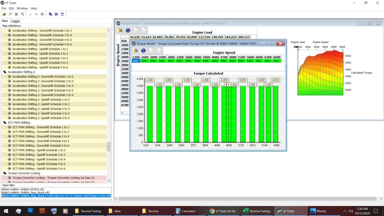

    I was wondering about these numbers. If you multiply the engine torque by the first gear ratio (AT 3.6) and by the rear end ratio (3.909) you get approximately the same numbers in the table below. Sort of the first gear 'axle torque'.
    The "Optimal Engine Torque" at max load looks suspiciously like the torque curve of the engine, though it is a bit higher than it should be above 4600+ rpm. Seems like this full throttle table should match the max load at each rpm. The max is 4928 Nm @ 5200 rpm... not far off the 5000 Nm some are putting.

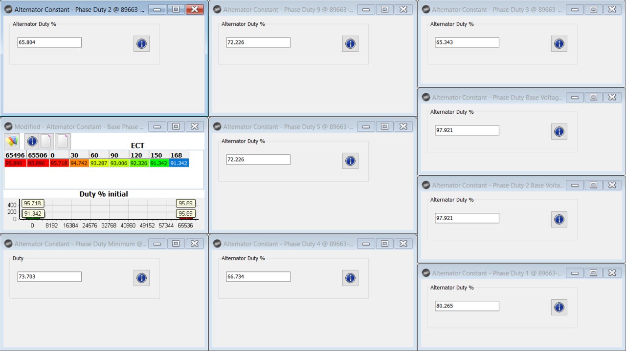

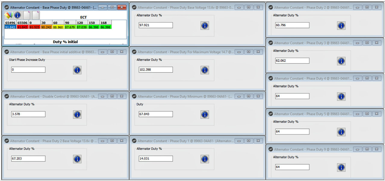

    Below are the stock alternator setting for 04A61. I think someone said the tables or values are different for different ecu's. Can anyone confirm this? If different does anyone have the values for agm charging for 04A61?

    Throttle request to Airload you highlighted and Control I or you used @ForceOfG's table? and raise the 4000 to 5000?
  18. Oct 12, 2020 at 6:01 AM
    #6458
    GPatriot
    GPatriot Well-Known Member
    Apr 19, 2016
    #184696
    479
    John
    Cincinnati, Ohio
    2016 Black Tacoma Sport 4x4 V6 DCSB AT Loaded
    KDMaxPro 10.0, OME 2" Med Duty lift, RCI Sliders, RoofRack, Skid Plate, etc.
    Yep
    Acceleration Throttle Request To Airload – yes CTRL I/made linear.
    Torque Calculated Base to Full Throttle – all to 5000 from 4000
    I have ForceOfG's settings screenshotted for later but I haven't tried/entered them yet.

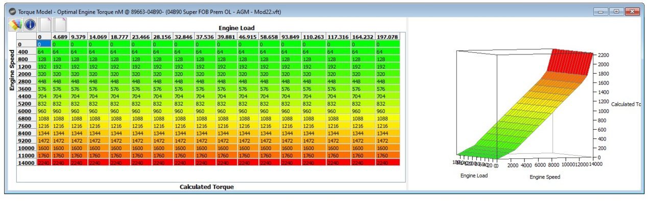

    Your logic makes sense, but I was thinking that the 4000 actually means 400.0 nM where the decimal is implied. I'm thinking some of the values in the ECU are integers so there are no decimal places just whole numbers.
    And Engine torque map for 04B90 MT makes no sense to me. I cant seem to hit that 14000 RPM....
