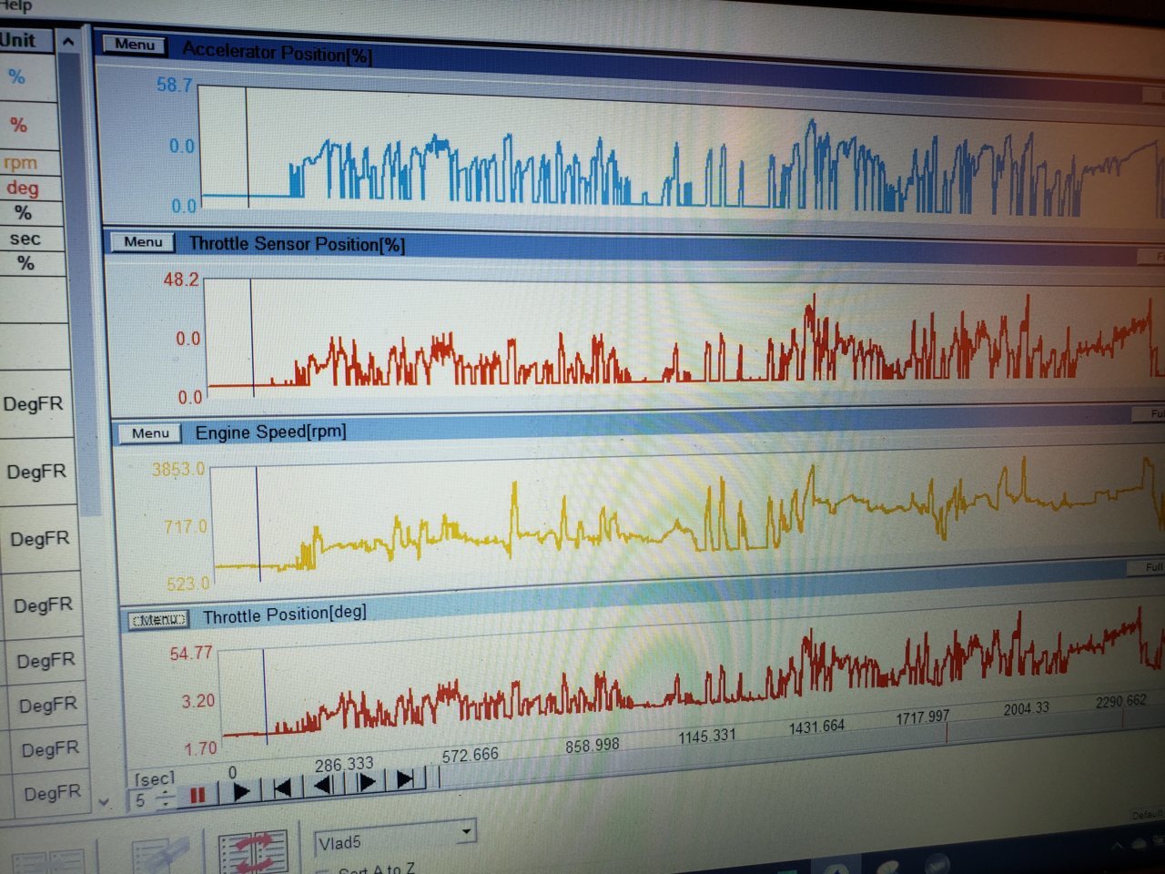

    Question. Per techstream, the throttle sensor position % at idle is 0. Where this 14% are coming from?

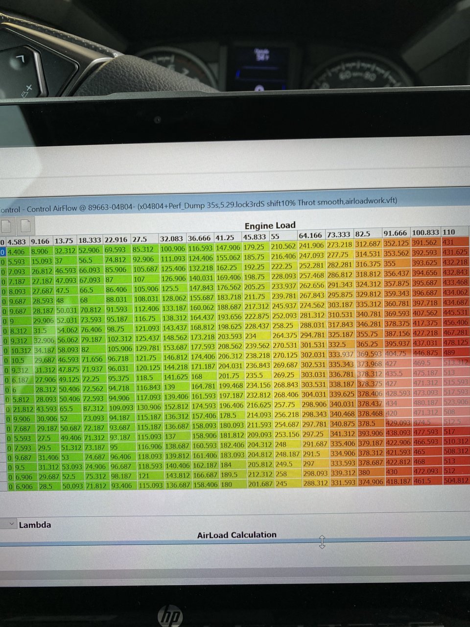

    On my new revision I made a few changes to try and get more sensitive throttle and so far so good!
    Along with the other changes in the Rev4 file I raised the throttle limits per gear 15% from where @ForceOfG had them to be linear. And I also raised all 4 airload tables by 10%. Not sure if it’s one or the other or a mix of both but it made a nice difference. Not sure how much were able to raise the airload tables before it messes something up, so that’s why I started with 10%.

    14% is where the truck idles. It won't close beyond that.
    I did once see 13.7 for a moment.

    Truck idles exactly at 0% of throttle sensor position or 3 degree of the throttle position (assuming it is the plate).
    These values are Techstream and OBD FUSION with Toyota PIDs.
    The reason I'm asking is that throttle sensor position is lagging by 30+% compare to accelerator and starting a "seesaw" dance under heavy load, high vehicle speed and moderate rmps, quickly running into the limits in the mountains and forcing the kick down to 4th and ASIC activation.

    Did you raise these tables by a percent?

    no I didn't. Just my thought of how to get more throttle. and more low end.
    here is what I have been working on. With decatted dump tubes. No check engine light.
