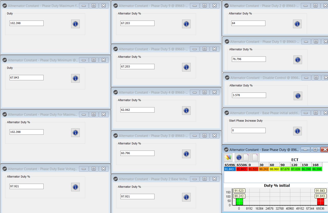

    @Rafael@OVTune can we have a thread added specific to tuning the alternator for AGM batteries?

    Here are the numbers from the 04B14 2.0 Premium OL tune. They are slightly different.

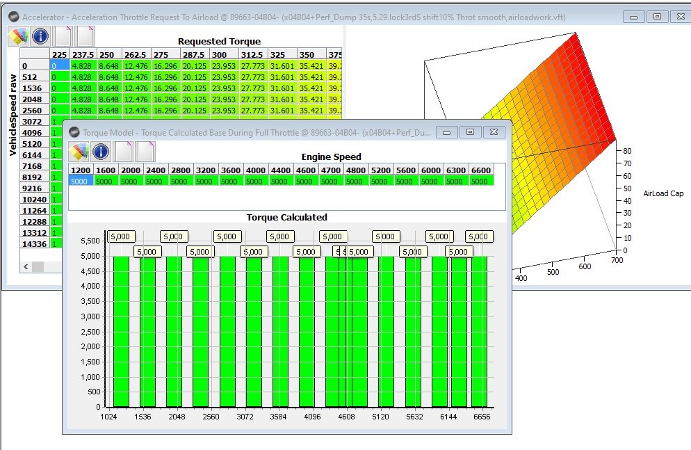

    These two tables adjusted as shown, are what unleashed first gear correct? 1st gear unleashed.jpg

    ok... i'm trying to play catch up here. running my latest tune, all you did was raise these values from 4k to 5k and you got full throttle in first gear. DA POWER has been unleashed? Or did you have to mod anything else? DAMNIT this is killing me. I can't even go run it.

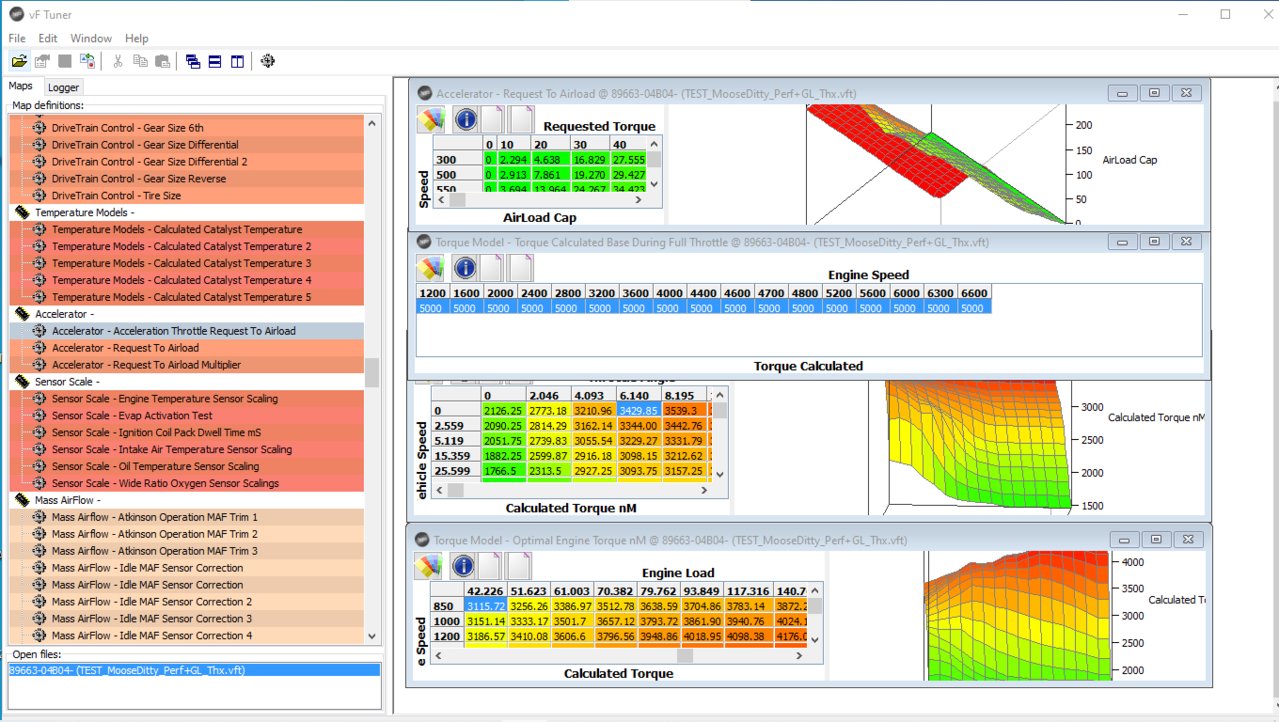

    Test Mods Tables adjusted.jpg I also feel these tables listed should be smoothed and or at least increased in the upper left low spots like I did here. Just doesn't seem right having that huge drop off there. I have not tried this! but I have the tune available if someone wants to be a guinea pig. It's the same tune as the last one I made, but has these tables increased and smoothed at the upper left value sections. If nobody bites, I GET IT. :D
    Anybody have their own ideas on these tables? Thoughts, input, reasons they should look like they do? All I can do is fiddle... Didn't even get to try the first gear stuff yet

    Correct!
    Mooseditty17 I adjusted the throttle too so it is more consistent with what I like. As seen in the quote

    I guess what I'm getting at, is were the throttle request table adjustments NECESSARY to unleash first gear's potential, or did it work with the values I had?

    I raised all 4 of mine 10% to see if it makes a difference. Not sure how much they can be raised. But 10% seems to make a difference.
