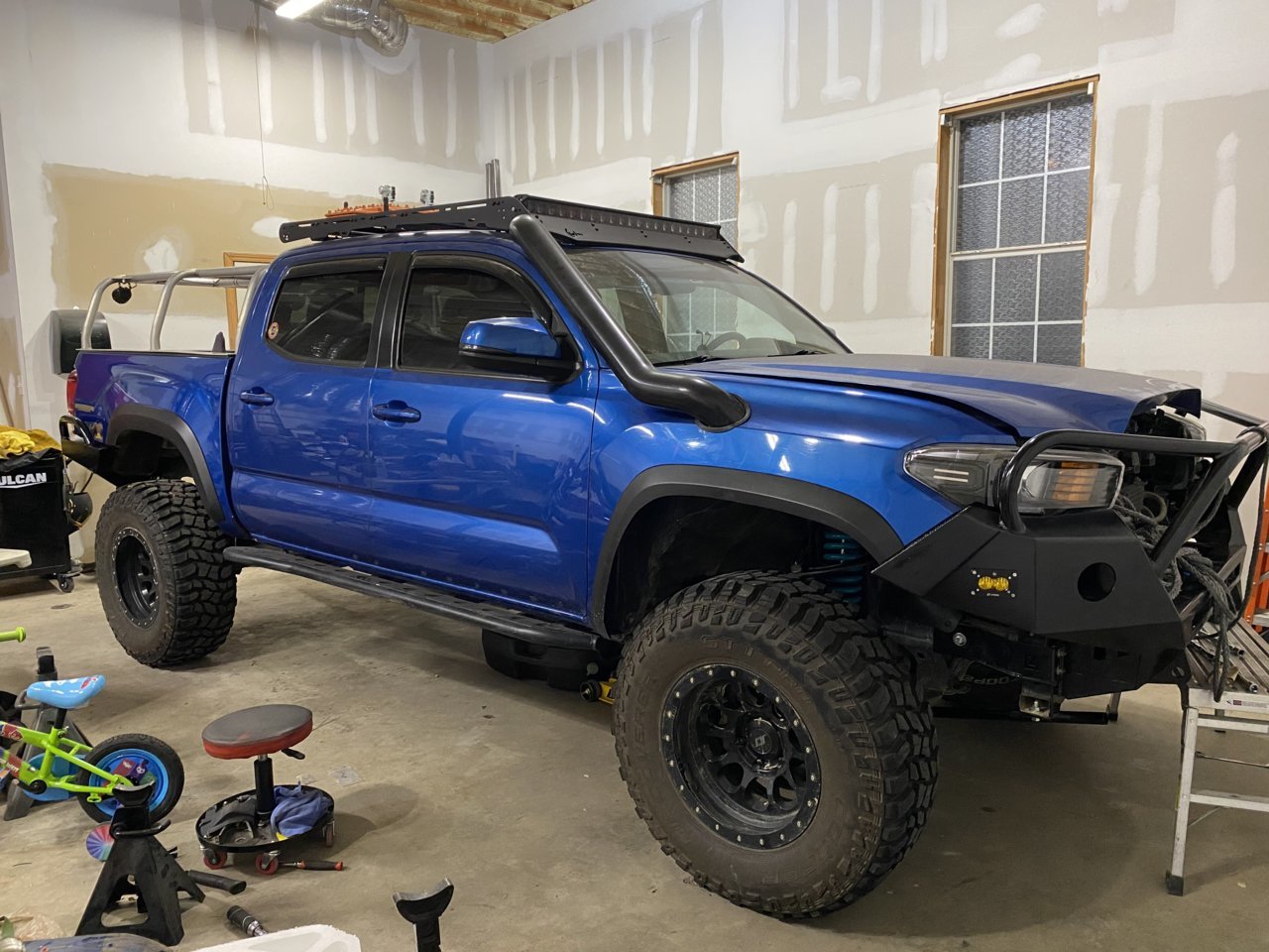

    04b04 tune guys. I have a very heavy truck with 5.29 gears with 35s and run 91/93 fuel. Can anyone help me out with a tune. I am running the red clay rally this weekend and still have a lot of things to get the truck ready. I was finally able to get the VF tune program downloaded. Any help would be greatly appreciated. Thank you in advance.

    Run the 5.29 35 tune. Premium or regular, either is fine.

    Look at post #6504. I think you’ll love that one.
