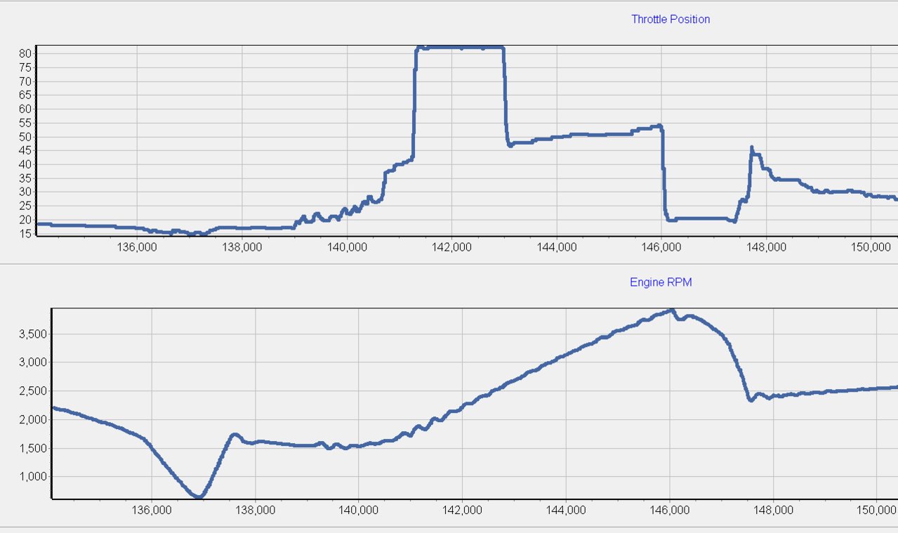

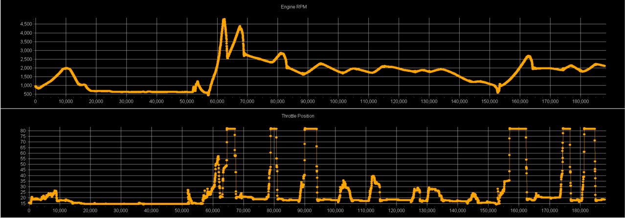

    I saw yours progress on tbe tune and your graphs. Should you be able to see a similar response in TS?

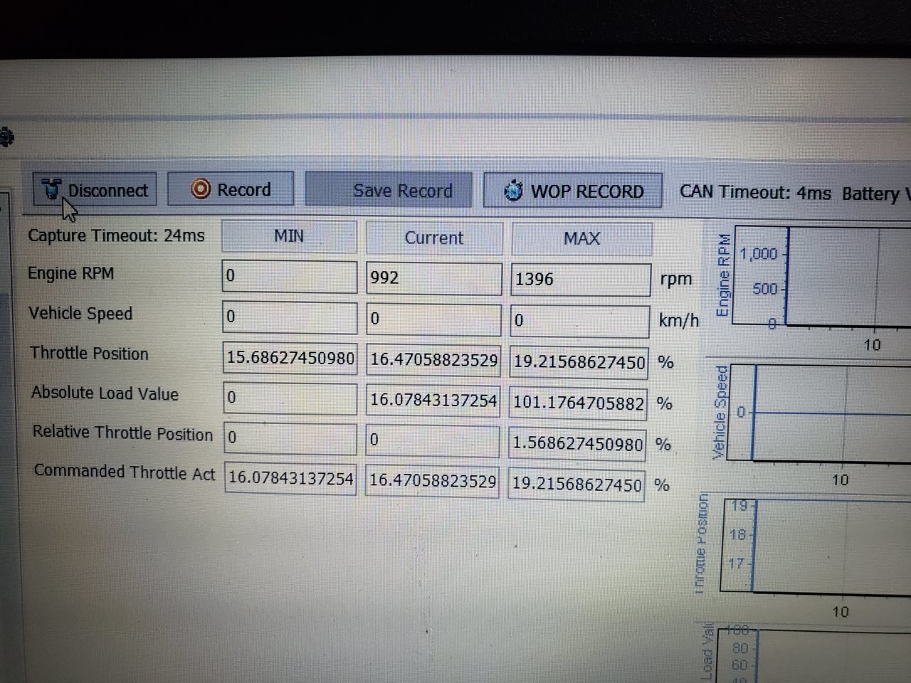

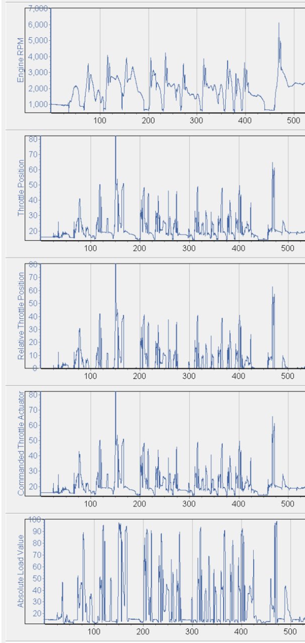

    Go to vf logger and note how many PIDs available. Start the engine and note how many left.Try select Relative accelerator position and then start the engine. See what happens with this PID after that.
  19. Oct 13, 2020 at 11:57 AM
    #6599
    OVTune
    OVTune Well-Known Member
    Mar 27, 2017
    #214557
    8,112
    OVTune
    The current PIDS it gives after connecting is the supported SAE PIDs.
    We are working on our logger which will include all techstream PIDs.
    MOC221_, Tharris242, GPatriot and 4 others like this.
  20. Oct 13, 2020 at 12:17 PM
    #6600
    Vlady
    Vlady Well-Known Member
    Dec 20, 2017
    #238986
    4,600
    Issy, WA
    2017 White SR5 DCSB V6 4x4
    Np. I figured that it is the case.
    So the VF commanded throttle actuator and throttle position = Toyota's throttle motor duty ration.
    Relative throttle postion= Toyota's throttle sensor position, which is 0 at idle. Correct?
    It would be nice to get accelerator position working, cause this is where I see quite a difference
