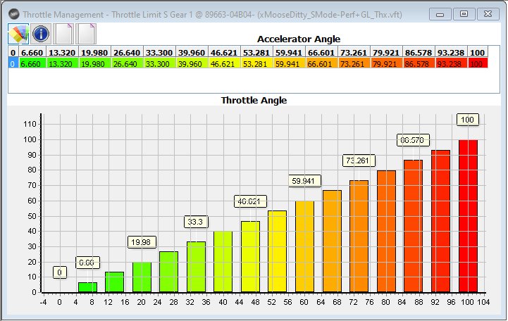

    Throttle request to air load and the throttle limits normal one through six. Control overall pedal feel.

    Let me know how it goes. I have done it, but it doesn't move the throttle. Here is a visual.
    Edit. I guess it depends which one is Vf throttle.

    Son of a b****.... Throttle nannies again huh?

    My guess is that the 2D maps you changed are the nannies. The accelerator request and airload control maps are where the real calculation occurs. Then the 2D throttle limit maps reduce throttle if the calculation is above what the maps allows.

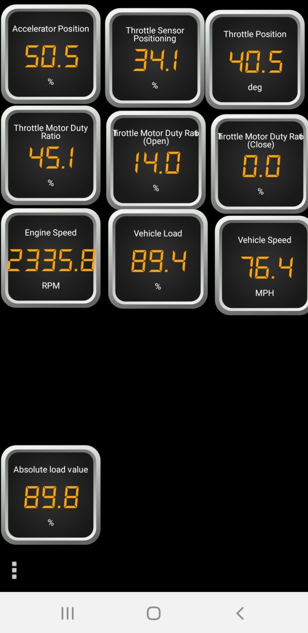

    The changes to airload tables that we told to try to are not producing the 1:1 ratio.
    I see 1:0.5+- with moderate engine load.
    1:0.7 @High engine loads.
    We may need to bump numbers in airload control/expected table or there are different tables

    A question I have been pondering: is the throttle valve always the limiting factor in airflow? Example: if manifold pressure is already calculated (because there is no sensor) to be at ambient, then the ecu may see no reason to further open the throttle. In this scenario if manifold pressure is actually at ambient, then there is no benefit to forcing the throttle open further. If it is below, then you would need to tune the airload control maps to refine the accuracy of the calculation so the ecu can go get more air.

    Well sadly I can confirm the S Mode trick doesn't work. Throttle map for S Mode overrides normal mode. It is certainly a snappier throttle but no different between the two modes. You could either leave it or copy all the S Mode values into the normal values for throttle limits. Still a snap your throttle than most of my tunes. Less throttle input needed for same result. Kind of like a pedal Commander.... I'm with @Vlady and @dunlap837, there's something else limiting these tables. We're going to find it have faith boys!

    I'm still trying to build up the courage to try that screenshot map. the one where I thought it would make more sense if all these things didn't have a huge dip on the upper left hand corner. Maybe I'll pull the trigger on that today yet...
