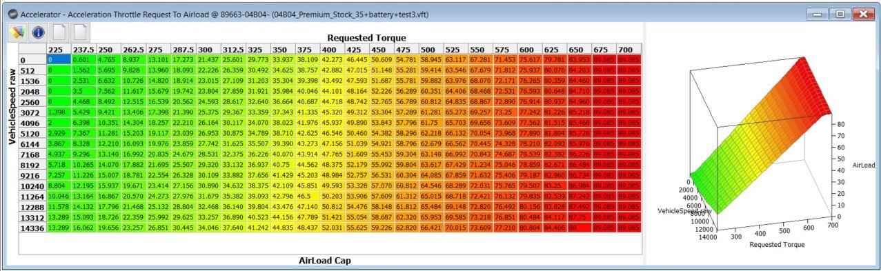

    On 10/1 one of the things I did was increase my Acceleration Throttle Request to Airload by 25% on all but last 2 columns and smoothed 450 to 650 only.
    Then on 10/10 when I changed the torque to 5k I also made the above table linear; an even increase from bottom to top.
    My mpgs have actually gone up one since the 10th, and I'm not easy on the pedal either. Loving it.

    Ok nice! Are you able to Select and up everything by 25% or did you do each box? I can’t seem to figure out how to mass up the map by a %. I have been playing with mine and got back to 20mpg with adjusting air load and request.

    Yes I just selected the range and hit * on the number pad on the keyboard. If you're using something other than a standard keyboard someone many pages back had a workaround for it.
    20?!?! With those big ass tires and whatever else you have? That's pretty damn good. I'm getting 19 which was where I was at before the winter fuel blend hit so I just gained that back.
    EDIT You select the range and hit * on the number keyboard like I mentioned, a multiplier window will pop up, and you put in 125 to add 25%

    Can you post a pic of this table?
    Also, for those without a numpad, Ctrl+Shift+8 is how you multiply.

    Sure thing, here you go:Screenshot 2020-10-15 180516.jpg
    Also for anyone interested that's running premium, here's a repost of all the changes I've made.
    Base tune is 04B04_Premium_Stock_35
    These are cumulative so my current tune "test 3" has all these in it
    Test 2 10/1/20
    ACIS Activation RPM High Engine Speed – 3400
    Control & Expected Airflow per OVTune
    Accelerator – Acceleration Throttle Request to Airload
    - All but last 2 columns *125
    - Smoothed 450 to 650 only (Ctrl+I)
    Throttle Management – Throttle Limit Normal Gear
    - Gears 1-6 (except last 3 values) *125
    - Same for S gears 1-6
    Primary Shifting Upshift Schedule 1-5 *115
    Primary Shifting Downshift Schedule 2-3, 3-4, 4-5 *115
    Test 2 Addon 10/3/20
    TC 3rd Gear S2 – set all to max
    1st Gear Throttle Limit – all to 100
    1st Gear Throttle Limit 4 High – all to 100
    Test 2 Addon 10/8/20
    TC 4th Gear S2 – set all to max
    Test 3 10/10/20
    Acceleration Throttle Request To Airload – CTRL+I / made Linear
    Torque Calculated Base to Full Throttle – all to 5000 from 4000

    did this last weekend on 04B14 for MT and turned out to be the golden tune... finally in the zone. btw, also tried ctrl-I on the ARA table and it wasn't so great. more here: https://www.tacomaworld.com/threads...tion-throttle-request-to-airload-atra.689760/

    Yeah my truck is very awake now. Fun all over again. I CTRL+I'd the expected airflow table in my first run but it didn't work so well either. On this acceleration table it's working pretty good so far.
