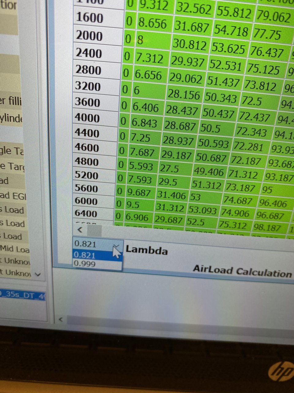

    So I think I understand now. So when afr is at .999 it reads off that map and when it’s at .821 it reads off that map correct? So it depends on how lean or rich your fuel is?
