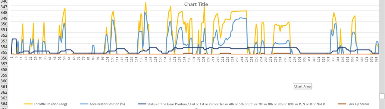

    So I made my changes jus like mentioned on page 303 for linear throttle. While data logging the throttle is linear under acceleration, however when cruising and easing back on to the throttle the throttle is spiking and is not linear with the accelerator. I'm wondering if it has something to do with regular request to airload table.

    Here's a graph of my linear throttle attempt. As you can see throttle position ends up above accelerator position often. Let me know if you guys have any ideas.

    What did you use to log?

    Obd fusion I exported the csv to excel and made a graph.
