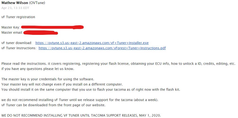

    One more dumb question since I'm still waiting for my Tactrix and the MT tunes to be released:
    With VF Tuner, do we only have to share our ECU ID with OVTune or do we have to share our computer info and then our truck info in two separate emails?
  4. May 6, 2020 at 1:25 PM
    #684
    tonered
    tonered bartheloni
    Sep 25, 2017
    #231055
    31,247
    tony
    Lynnwood, WA
    For vF, your account is based off of your order. You don't need to send anything in. Once the ECU that you want is unlocked, you'll just grab it and spend the credits.

    Whoa! Huge if true and a huge timesaver for OV. I may have misunderstood the directions that come in the email or they may still have a lot of copy/pasta from the older flash manager days. Looking forward to testing this out!

    The Master Key still comes from ECUTek in the UK, but yeah, less to manage.
    After the order notice, this was the only email that I got when upgrading from the dongleless Flash Kit. Yours should be similar?
    It is said that we will get another for the Tune Pack.

    Other than initial registration, you don't need us at all for ecu unlocking, editing, flashing, etc
