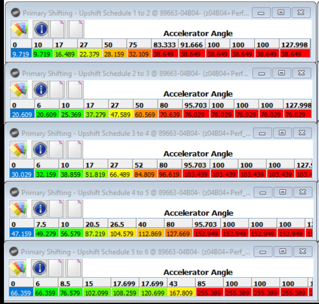

    TL;DR - the throttle limit per gear tables need to be fixed... and fixing them will mess up your shifting and converter tables. Attn: @dunlap837
    Here's why the AT "lugs/bogs/deccelerates" after upshifting and "launches/surges" after downshifting (in most circumstances).
    Aggregated below are the "throttle limit normal gear" tables for the stock tune (OVtune non-THX is unchanged from stock; THX is modified but has the same problem). Top line is accelerator pedal %.
    Everyone knows the stock tune 'bogs' when it shifts from 3rd to 4th under normal acceleration... Why? Let's say you are gently accelerating from a stop at 13.8% pedal, which gives you 3.3% throttle. The transmission shifts into 2nd where it gives you 4.7% throttle for the same pedal position. Why the change in throttle? You just reduced your wheel torque/leverage by 1.78x after shifting to 2nd. To maintain the same power/acceleration you need 1.78x more torque... and the tune gives it to you. Shifting to 3rd, it gives you still more (7.4%) to compensate for the upshift. Now... shift to 4th... see the problem? Still 7.4%, even though the wheel torque/power is reduced by ~33% (theoretically, with some caveats). You'll now have to press the pedal further (>5%?) to make up for the reduced torque. Repeat for 5th gear. Of course, the opposite happens on a downshift when ascending a grade... more torque/power than you expect.
    Now we know how to fix it, in principle; but, what should the numbers be? That's a more difficult question; because... well... a few reasons. You can see some below. If throttle % and torque were linearly correlated (they are not) the "Ideal" numbers below would be what you would want.
    You can't go over 100% and you don't want 6.3% throttle at 2.8% pedal in 6th gear. You'll have to make some compromises... but, do keep in mind you'll never need 100% throttle in 6th gear... you may not even need 50%. Same for 5th, etc. You'll want it to downshift before you'd need that much throttle.
    It may be desirable to have some up/downshift discontinuity... maybe around 10% or so? If you're forcing a downshift, you probably want more power... conversely, you may be upshifting because you're lifting off and want less power.
    Simply raising the shifting points does not address this issue. It's lugging/bogging/deccelerating on the 4th gear upshift, etc. because that is what it is programmed to do.

    Are your charts taking into consideration the different access values for 4th, 5th and 6th throttle limits?

    Axis? They are all the same on the files I've looked at.

    I may have been thinking about the shift maps. Either way, the gray values at the top, the x axis, are different on the shift maps. Meaning they are asking for a certain speed, at a different accelerator angles. This is the only screenshot I have at my disposal at the moment... Screenshot_20201005-204412.jpg

    No, not the shift maps... the "throttle limit normal gear #" maps (and S gears) under Throttle management. The axes are all the same.
    But again, if you change the throttle tables you'll drive with the pedal in a different position; so, it'll shift differently.
