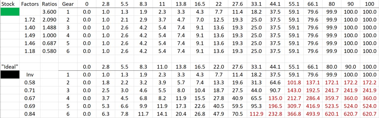

    My 2 cents o these tables and numbers.

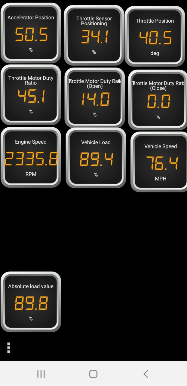

    I had\have more aggressive numbers in 4,5,6 gear tables, linear&curvy airload table and I could not match the accelerator to the throttle in my data logging.

    So, 'linear throttle' in 5th, @D2H ? Seems several people are chasing the throttle=accelerator "ideal" for reasons I am not quite clear on. You could do that if you want; but, the important point is how the values for each gear relate to the gear before it, or after it. If adjacent gears are the same you will have the 'bog'/reduction in acceleration on upshift and the 'surge'/increased acceleration on downshift no matter what you do with the shift tables. (Another reason the cruise control can be so jarring on downshifts.)
    IOW, with the stock tables (and OV), if you lock the accelerator in one position at a steady speed in 5th gear... and you shift into 6th, you will slow down... shift to 4th, you will speed up. I don't want my speed/power/acceleration to change so significantly after shifting while driving normally.
    Coincidentally @Vlady , it occured to me today that these tables probably aren't referencing 'throttle angle' as they are labeled. Now, I'm thinking they reference % of max air flow... they are in the 'throttle airflow' section, after all. So, perhaps the 'ideal' numbers in my chart are actually ideal, if impractical. (Ideal because % air flow is ~linear with power; throttle degrees are not.)
    I'm trying to sort all this out logically and mathematically (as the ECU does). I'd like to connect the dots from the accelerator to the optimal engine torque table as I believe that would allow me to determine the most logical (and efficient) shift points.

    Dec 20, 2017
    #238986
    4,700
    Issy, WA
    2017 White SR5 DCSB V6 4x4
    I would agree. These numbers are not related to the throttle.
    Here is my example of climbing a moderate incline.
    My table for 5th and the "lets assume accelerator angle" =50.5 should be producing about 65-70 whatever of the throttle limit.
