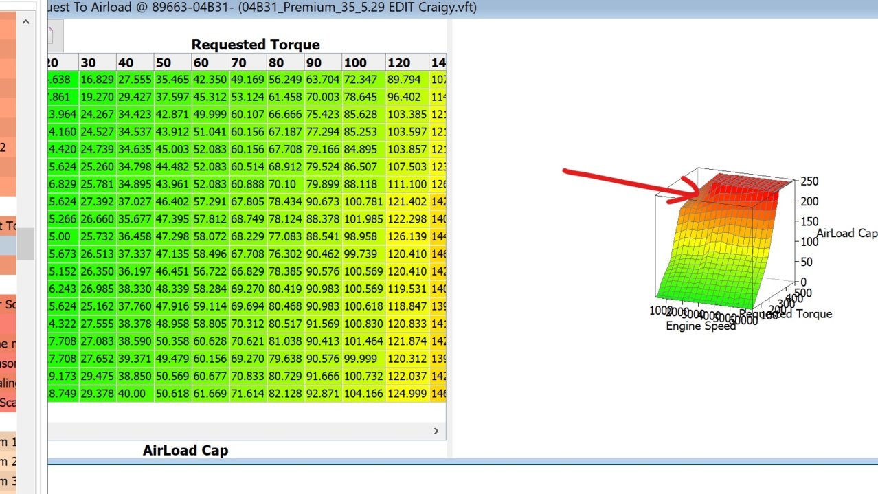

    No worries dude. Here is what I think you were after. Load it in vF and use the compare to see what all I tweaked vs. what you posted. I did my best to match @Mooseditty17 and @PapaRee latest versions. I thought I was pretty thorough in this, but they've been so busy it can be hard to keep up with all their changes. I got throttle, ACIS, airload, gear lock, and shift points for both D and S, etc...
    **Edited, I forgot to smooth the Accelerator Throttle Request to Airload map and fuel cut offs. I made the update to the file attached below. "Should" now have all the MD and PR updates. I keep finding nuggets as I look closer.
    For all, this is a 04A61 Premium Gearlock tune that mimics @Mooseditty17 and @PapaRee latest versions. I'm running the 04B04 version with some AGM and other minor tweaks and it's super solid on my truck. How it translates to the A61 ECU is TBD. Plan to load it on a friends truck next week.
    As always, I recommend everyone loads and inspects my work before flashing. I do it with other user tunes as well. If I missed something, please keep me honest.
    Also, @OVTune any chance you’ll develop the function where we can select the entire map on the left map tree and copy and paste it into another tune? That would save massive amounts of time.

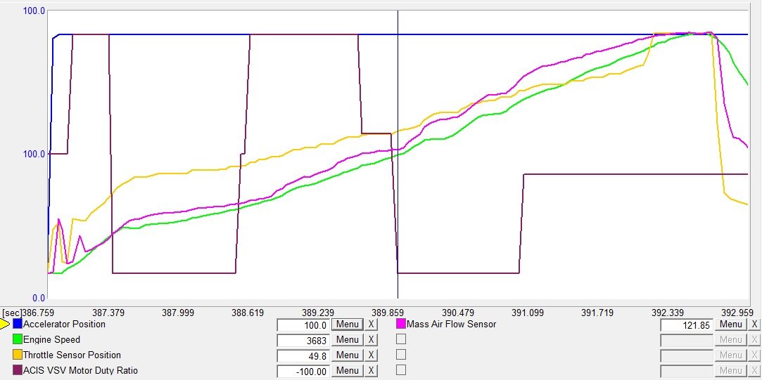

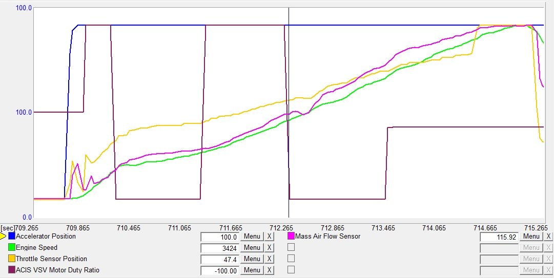

    I wonder if they are trading power and smoothness for placebo.
    Here is a first gear pull with stock/OV 3650 ACIS. Definitely a little kick in air flow after the ACIS switch.
    Here is a first gear pull with the 3400 ACIS 'mod'. Definitely a reduction in air flow after the ACIS switch.
    (Yes, I have done all the first gear full throttle hacks.)
    Also, notice that ACIS does not appear to just open or close at one rpm. It appears to also have a half/neutral/both position with multiple changes throughout the rev range. We don't seem to have full control (yet?). But, it looks like Toyota may have got the stock settings right.

    Log what your throttle position is and lower the value of the next highest throttle position.
    So let's say you're doing 60 MPH and your throttle position is approximately 28%
    Lower the value under the 52 axis 5-10 mph.

    The reason everyone changed the acis settings was per @OVTune's recommendation His findings on the dyno showed a sweet spot around 3,400.

    In those runs what is the MAF reading at the top end of the RPM range? It may be placebo but it feels like the intake is able to recover sooner from the runner length change which could be why it feels better. The power difference feels negligible but the smoothness is a lot better. Also if you dig up an old post by Mat he mentioned that he also needed to do some intake VVT changes to get the full benefit of a lower ACIS activation.

    Great stuff. Do you see the same behavior at mid throttle? That is where the stock tune really falls on its face.
    IMO the ACIS isnt really that bad of an actor. If I hold a gear and run up through the rev range I don’t notice it too much. But on the stock tune it seemed you could downshift, intake valve advances, throttle opens, and acis state changes kinda all at the same time. With my higher shift points now I never get the 2 cycle surge, and I haven’t messed with acis. I think its just that I’m no longer making all of those things happen at the same time.
