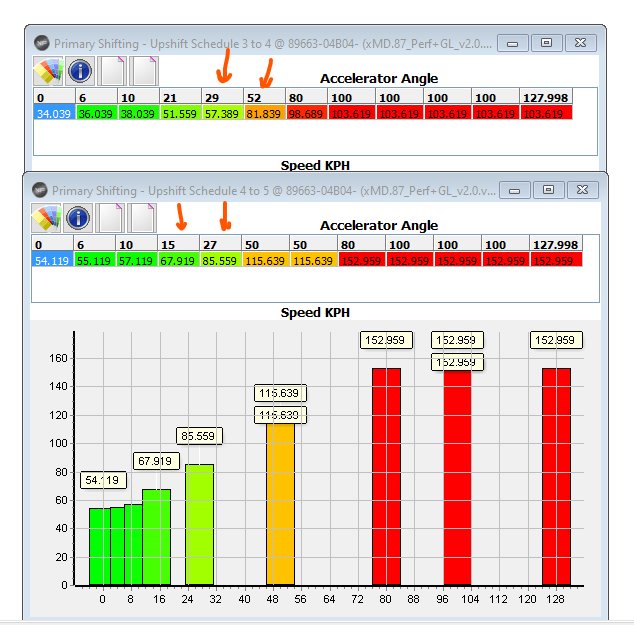

    im using the newest map that you and @PapaRee and whomever else worked on and it is great except it holds 3rd and 4th a tad too much (like 5mph). I’m on 4.88’s and 32’s. I’m wondering if is because the tune is configd for 33’s? Could this 1” do that?
    also, it definitely eats more fuel (3-4mpg avg), but that’s partially my fault. :anonymous:

    #7085
    TWTaco
    TWTaco Well-Known Member
    Dec 19, 2015
    #172601
    5,967
    Dave
    I dont think its from the 1" tire difference. It could be the gearing.

  8. Oct 24, 2020 at 5:54 PM
    #7088
    Mooseditty17
    Mooseditty17 Seasoned Rookie
    Apr 7, 2019
    #289395
    1,681
    AJ
    WI
    2017 TRD OR : M+W Nexus Tuned
    Tune: Nexus +P Add ons: +3" custom suspension 295/70/18 Yokohama M/T Tires KMC XD Grenade OR wheels KN intake Blackhawk MBRP Exhaust TJM Rock Crawler Bumper Lighting (+10 H.P.)
    For the 3-4 upshift try lowering the 29 angle down 2 kph and the 52 angle down 5-7 kph
    For the 4-5 upshift try lowering the value under the 15 down 2 kph and the one under the 27 value down 5 kph. I'm guessing this is the range of pedal your foot is in when cresting a hill, so lowering these values will prove to be the resolution. Remember, somewhere in-between the two values are more values that you just aren't seeing, that all relate to accelerator angels you also are not visually privelaged to.

    Since we have had some people saying that 3rd gear and 4th gear were hanging on too long, I adjusted the upshift tables on our most current tunes.
    I also smoothed the Acceleration throttle request to airload table and reverted back the 4th gear 2 torque converter settings. Let us know if this is better for you.
    Premium and Regular octane. GearLock and No Gearlock

    Here you go, 4.88 and 32" tires with the upshift adjustments to hopefully fix your problem.
