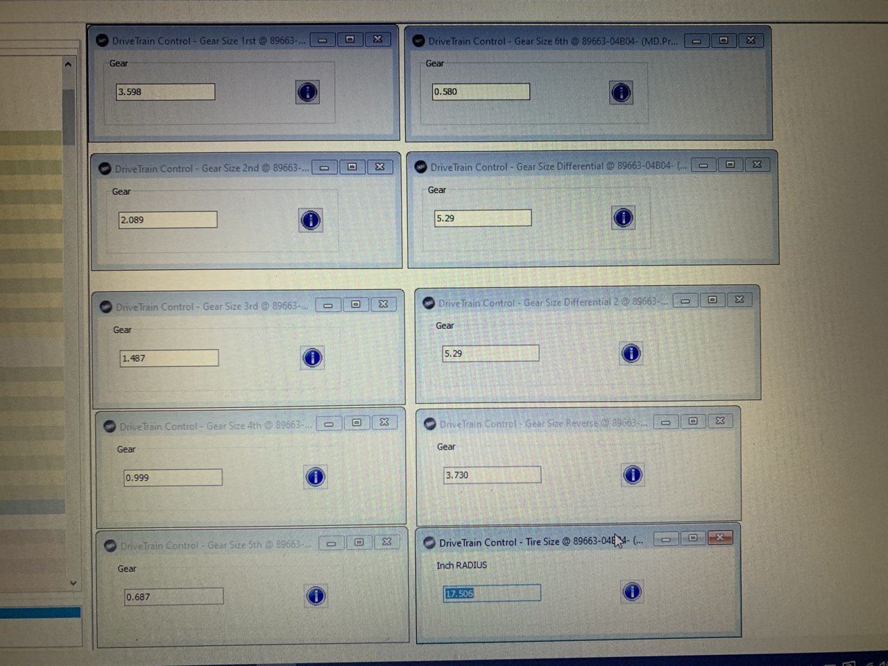

    how did you figure out the conversion to what you have based on your gears for the gear values 1-6?

    I believe that those are the actual ratio of each gear.

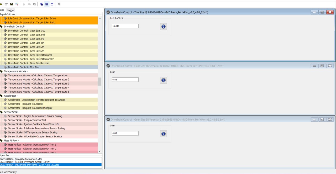

    Yes. The differential 1&2 will be 4.88. And the tire size for you is 16 (radius of 32).

    Just opened the file I posted for you. This is what I see

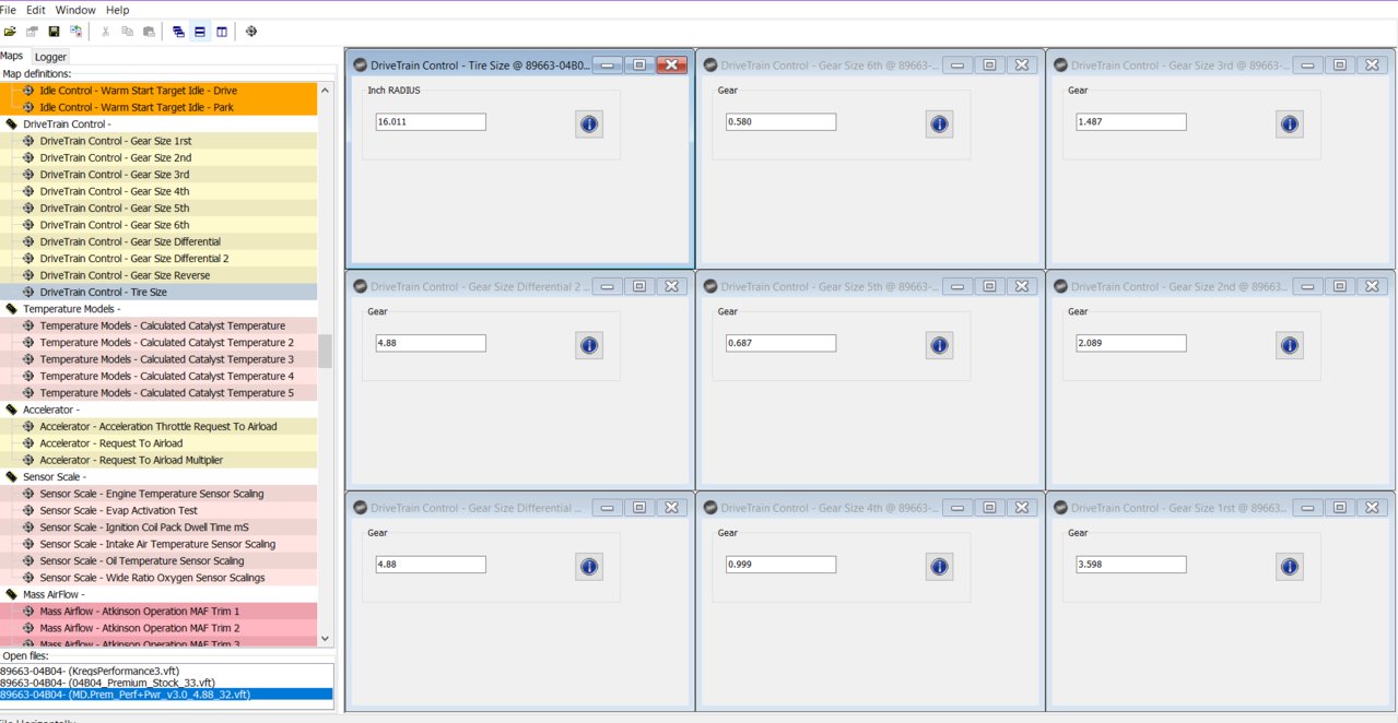

    This is the file that is posted. Not sure why your numbers are different. But this is what they should be for your truck.

    @SpeySquatch may not be on the most recent version of vFT. These tables were not scaling properly in older versions

    ahhhh need to update
