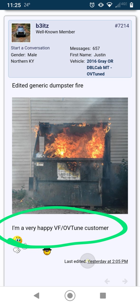

    this thread = dumpster fire (once a week at least)
    vf/ov = awesome ROI

    Fridays used to be the official start of dumpster fire weekend
