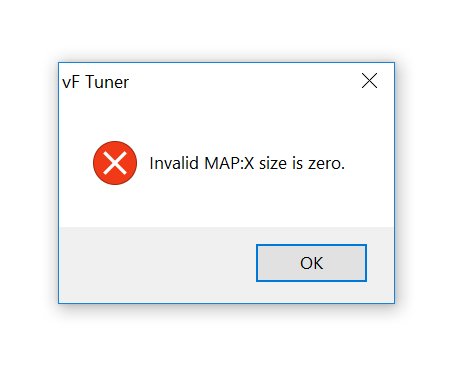

    #7350
    InternationalHarvester
    InternationalHarvester VF Pro Licensed, KDMAX Authorized Vendor
    Nov 20, 2017
    #236484
    725
    Sierra Nevada
    2017 TRD DC LB OR 4x4
    KDMAX Tooooned
    This is what I get when I try to compare files. Anyone know what I'm doing wrong?
  11. Oct 28, 2020 at 5:34 PM
    #7351
    OVTune
    OVTune Well-Known Member
    Mar 27, 2017
    #214557
    8,112
    OVTune
    update vF Tuner
    ihatemytruck likes this.

  13. Oct 28, 2020 at 5:43 PM
    #7353
    Nov 20, 2017
    #236484
    725
    Sierra Nevada
    KDMAX Tooooned
    Updated VF... avoided the pop-up, but doesn't seem to be working. The stuff that appears in bold seems to have the same values between maps
  14. Oct 28, 2020 at 5:57 PM
    #7354
    wahoobie
    wahoobie TidewaterCustoms.com
    Nov 6, 2016
    #201692
    2,186
    chris
    Suffolk, VA
    2016 DCLB 4x4 SR5ish
    VA/Remote Elite Performance Tuning Services
    Next release should address that
    b3itz likes this.
