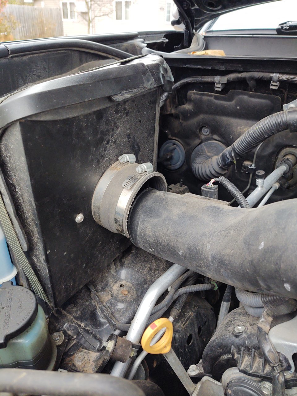

    Avid front bumper guard OVtune HPS Intake Tube Meso designs counting
    And they wonder why we hate going to the dealer.

    another lesson in life - Never ever leave any service provider (especially the Mothership) without checking for damage and incomplete work even if it is something simple like new tires, a tire rotation, or oil change. They always find a way to F' it up. I've seen many cases of loose lugs, wheels fall off and no oil after the Stealer "completed all work."

    This would be my thought too as I'm certain that with as closely as @Mooseditty17 has been paying attention to his motor with all the tuning he is doing that he would've noticed the sound change with an open intake. It should be very noticeable at wot

    Sounds about the same as I have a KN blackhawk intake. What was a dead give away, is when trying to reconnect, the bottom half of the coupler was folded in. They thought they had it, but didn't. Then the half clamped intake tube probably worked it way off completely, over time. How long?????
