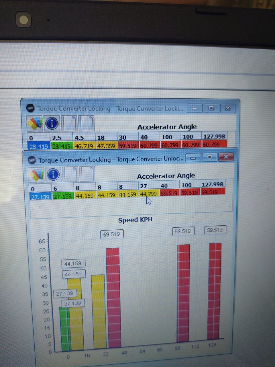

    So if you think about it as a steady accelerator position, let's say 30% accelerator angle the truck locks up at 60 kph. If you maintain that position, it will unlock at 45 or 46. So in that logic, lower holds longer....IMG_20201030_101538385.jpg

    Raising the unlock will make it unlock more. You need to lower the unlock. Keep in mind it will shift and stay unlocked until you pass the lock or partlock thresholds.

    I will confirm this is correct. I lowered the unlock values, raised the first two lock values by 10 and the remainder up by 5. Very similar setup for the slip lock. 4th gear is absolutely magnificent! No up down nonsense and nice smooth pull throughout the gear. Beautiful transition into 5th as well. I attempted to mess with 3rd as well, but that'll be another day. Literally 2 weeks driving has equaled 1000 miles! Dear lord, I think I need a 12 step program!
