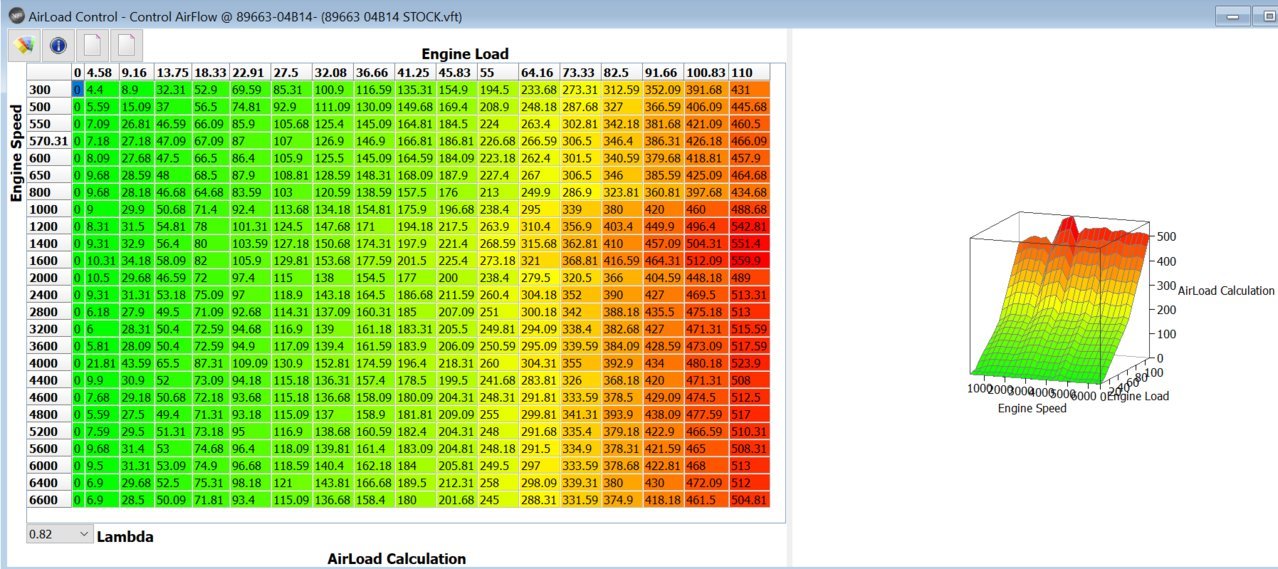

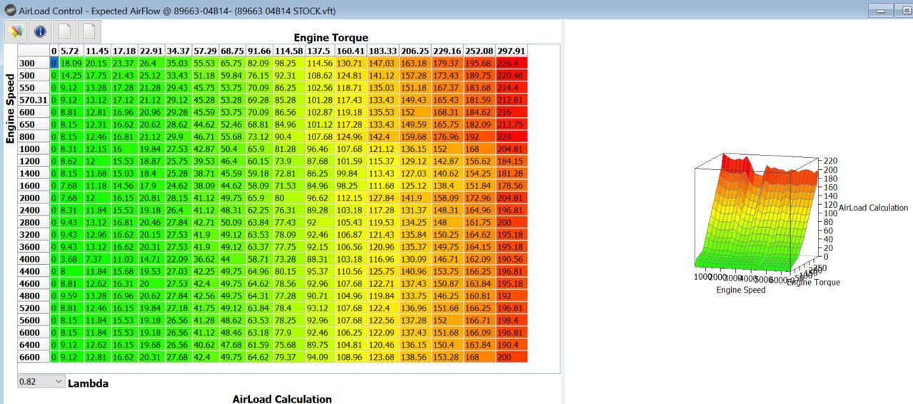

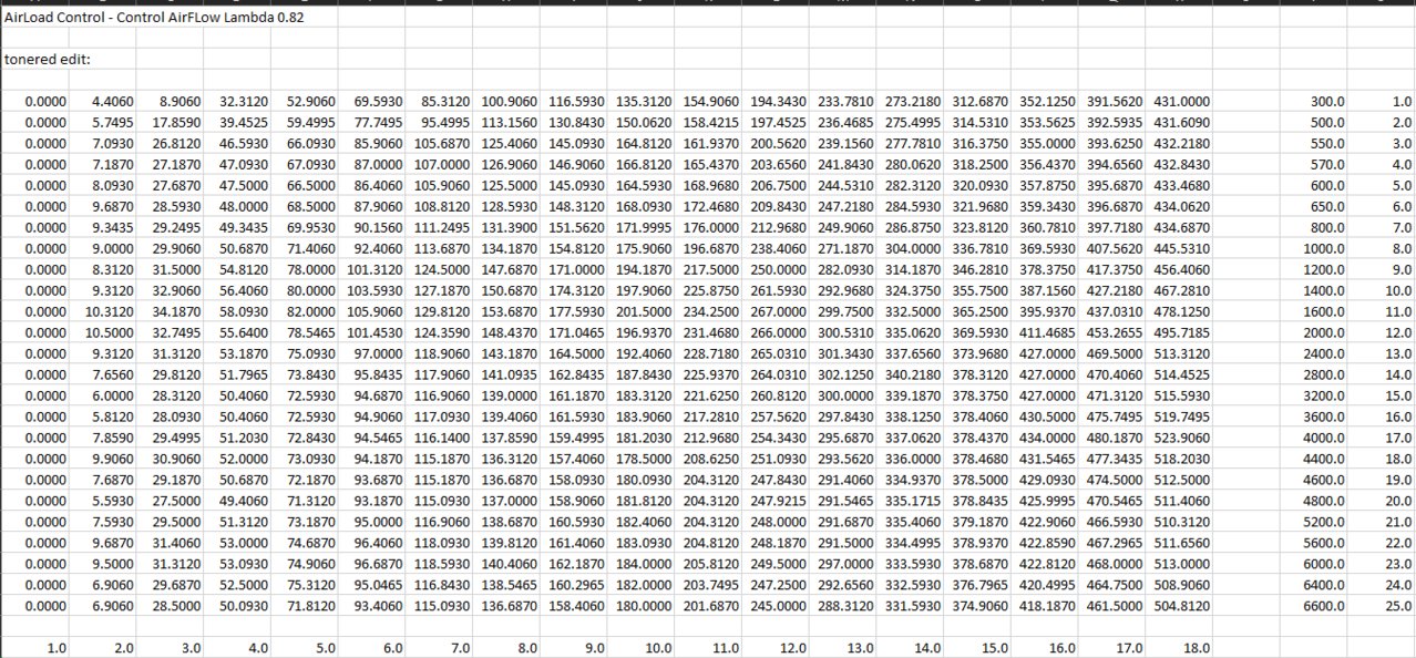

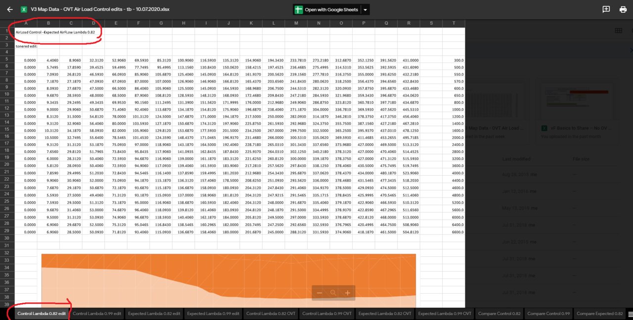

    So, when I am going over the air flow tables from your spreadsheet, I see something like this: Notice the tab I am in (bottom left) vs what is writing at the top left.
    So do I paste the values in expected or control?
    tonered likes this.

    Good pickup. The tabs are in the correct order. The titles in the spreadsheet were wrong. I am updating the file attached to the thread.

    Ok, when I paste the values under the control tab to the control map and expected tab to expected map, I do not get an error.... It seems that the tab name and vs what you wrote is backwards....?????:notsure:

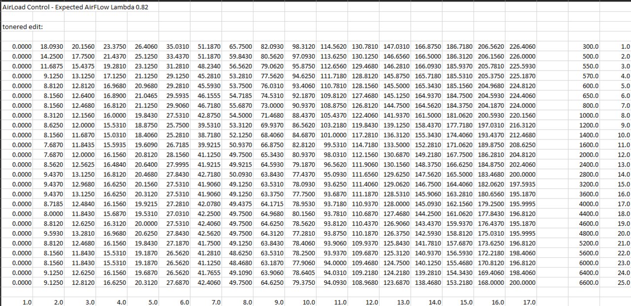

    Control is a 25 x 18 matrix, so:
    And Stock:
    Expected is a 25 x 17 matrix, so:
    Stock:
    I hope this helps?
