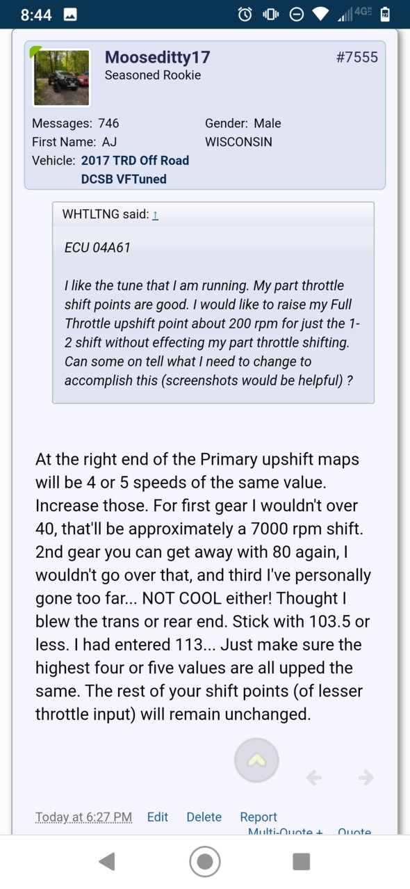

    ECU 04A61
    I like the tune that I am running. My part throttle shift points are good. I would like to raise my Full Throttle upshift point about 200 rpm for just the 1-2 shift without effecting my part throttle shifting. Can some on tell what I need to change to accomplish this (screenshots would be helpful) ?

  8. Nov 2, 2020 at 4:27 PM
    #7548
    Mooseditty17
    Mooseditty17 Seasoned Rookie
    Apr 7, 2019
    #289395
    1,681
    AJ
    WI
    2017 TRD OR : M+W Nexus Tuned
    Tune: Nexus +P Add ons: +3" custom suspension 295/70/18 Yokohama M/T Tires KMC XD Grenade OR wheels KN intake Blackhawk MBRP Exhaust TJM Rock Crawler Bumper Lighting (+10 H.P.)
    At the right end of the Primary upshift maps will be 4 or 5 speeds of the same value. Increase those. For first gear I wouldn't over 40, that'll be approximately a 7000 rpm shift. 2nd gear you can get away with 80 again, I wouldn't go over that, and third I've personally gone too far... NOT COOL either! Thought I blew the trans or rear end. Stick with 103.5 or less. I had entered 113... Just make sure the highest four or five values are all upped the same. The rest of your shift points (of lesser throttle input) will remain unchanged.

  13. Nov 2, 2020 at 6:16 PM

    Sorry, I forgot the screenshot in my first response. Hope this helps...
    Stormpeacock and WHTLTNG[QUOTED] like this.
