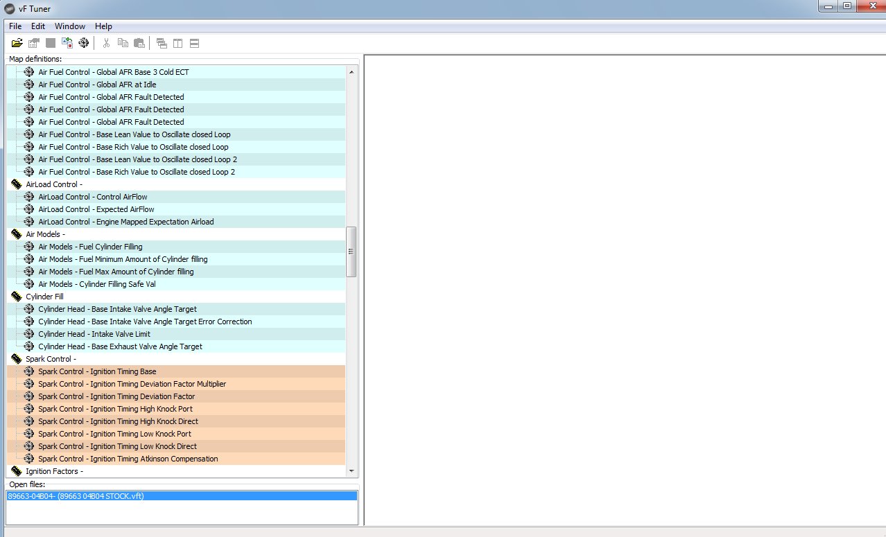

    Exactly... Now that I have some time (the children are asleep) this is what I am looking at:
  8. May 8, 2020 at 9:20 PM

    None of those maps shown have had similar “tuned” maps shared from OV that would guide you into making changes. My opinion is to wait until OV releases the “tune packs” and then compare different tunes to see maps and values changed. Myself and I’m guessing 99% of everyone else are too dumb to just start making changes to all the current maps available.

    That is correct and my plan. For now, I am aiming to familiarize myself with the program.
    One thing I guess I need to do is copy and paste the file, then rename it. There is no option to "Save as."
    I have no way of knowing what any of this is, yet. However, I am willing and eager to learn (with this computer and Tactrix forever onboard).

    “Export” is the “save as” option.
