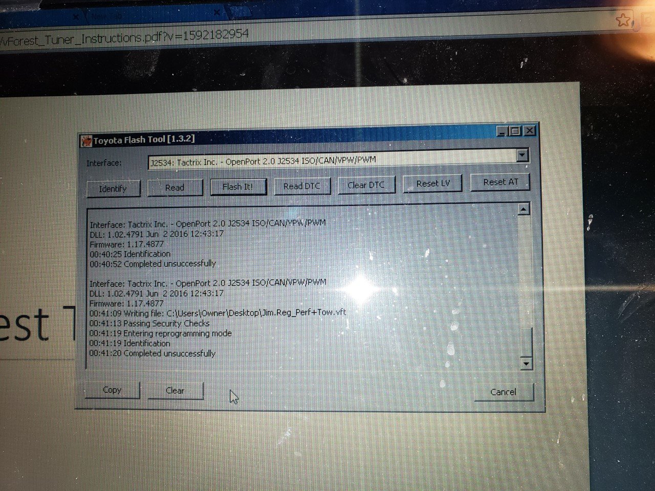

  17. Nov 4, 2020 at 4:58 PM
    #7597
    cheesehomer
    cheesehomer Active Member
    Mar 31, 2019
    #288597
    33
    2018
    3 inch lift , 20 inch rims
    I haven't been able to Flash it, i keep getting an error , just tried again tonight.
  18. Nov 4, 2020 at 5:07 PM
    #7598
    Mooseditty17
    Mooseditty17 Seasoned Rookie
    Apr 7, 2019
    #289395
    1,681
    AJ
    WI
    2017 TRD OR : M+W Nexus Tuned
    Tune: Nexus +P Add ons: +3" custom suspension 295/70/18 Yokohama M/T Tires KMC XD Grenade OR wheels KN intake Blackhawk MBRP Exhaust TJM Rock Crawler Bumper Lighting (+10 H.P.)
    You didn't even identify successfully
    Uscgamecock7 likes this.
  19. Nov 4, 2020 at 5:07 PM
    #7599
    Mooseditty17
    Apr 7, 2019
    #289395
    1,681
    AJ
    WI
    Key all the way on? Not running? Pushed start twice?
    double_duez and tonered like this.
  20. Nov 4, 2020 at 5:19 PM
    #7600
    wiljayhi
    wiljayhi “..ain’t nobody’s business if I do…”
    Oct 8, 2018
    #268685
    2,635
    Jim
    Murky Water, MB, eh?
    3G, Tuned
    Don’t know. You’re on the latest version of vf flash tool? System ID ok? ECU is 04A61?
    @tonered , any ideas?
    tonered likes this.
