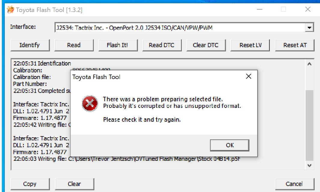

  18. Nov 6, 2020 at 9:18 PM
    #7698
    CorbinDallas
    CorbinDallas Well-Known Member
    Aug 17, 2019
    #302467
    378
    Corbin
    Tacoma
    16 MT OR
    am trying to go back to the stock 04B14 TSB file. Since I have a OV 04B14 file flashed, techstream will not allow me to flash the TSB.
    When I first flashed the TSB, I used the flash utility to read the ECU creating a p5f file.
    Now, when I try to use the flash utility within VF tuner, I get this error message: Is there a way to go back to the TSB file? @OVTune
  19. Nov 6, 2020 at 10:34 PM
    #7699
    tonered
    tonered bartheloni
    Sep 25, 2017
    #231055
    31,330
    tony
    Lynnwood, WA
    In the vF file structure, there is an 04B14 Stock file. You can flash back to stock with that.
