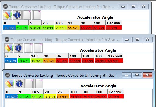

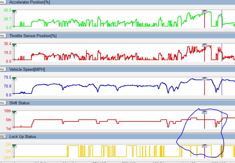

    it is pretty much 2.0 stock. This afternoon I made an attempt to move numbers up and it did not work (3rd table). I just cant grip on the direction at high speeds. And you are correct, it wont unlock no matter how much pedal you give. Thanks

    Not sure which table applies to which map there but it looks like you're letting it lock above the maximum unlock speed and when that happens it'll never unlock unless you go back under that maximum unlock speed. So you should raise the TC unlock speeds. If you want them to unlock up to 80 then set the values to 90. You dont have to adjust the lock tables since the unlock tables override them. Give it a shot and let me know if it doesnt work but from all the testing I've done thats what would work for me.
    Make sure you modify maps 1-4, maps 5-6 are used under separate conditions, likely while the engine is still cold.
