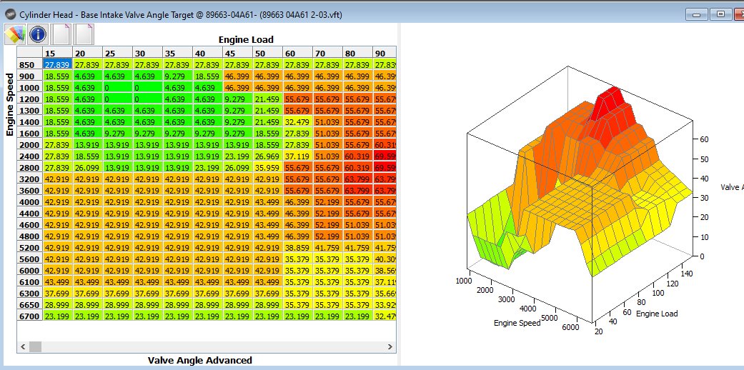

    So I raised TC unlocking speed to 85 in 100 columnsupload_2020-11-11_23-44-0.jpg
    Went for test and still no joy.
    Speed was 75.8-78 mph, accelerator 37-43 % . I need to wrap my head around this. I may need to raise to 120 , then if my math is correct, 43 accelerator would be around 77 mph. It should unlock if I below 77. Correct?

    The earliest the intake valve can close is 25° ABDC (after bottom dead center); the latest is 105°. That's 80°; but, the map only goes from 0 to 69.599 (0° to 75° actual). So, I don't know if 0 in the map is 105° or 100° ABDC and if 69.599 (75°) is 30° or 25° ABDC.
    The last Tacoma V6 without VVT closed intake at 42° ABDC... always. Air is still flowing in at BDC; so, you get more if you leave it open for a bit. (The previous V6 VVT delayed up to 60° ABDC.)
    I just tested some lower numbers in the 15% column and the 850 rpm row (and reverted some of the OV numbers back to stock). Everything ran fine. Unfortunately, at 0% accelerator it doesn't use this table... it's always 30°. So, yes, it sounds like there are more tables.
    As @ForceOfG of mentioned, it probably would be ideal to re-tune the ignition timing to the valve angle. I'll add that the direct injection timing also appears to be tuned to the VVT angle. (But, both of these OV tables are unchanged from stock, so... I guess it's not that important?)
    I have seen in one of my logs a ~45° change in ~50 ms for the intake VVT. That's probably faster than you can stomp the accelerator from 0 to 100%.

    Yeah, you didn't breach the threshold to trigger the unlock.
    And yes, looks like your math is correct for 120.
