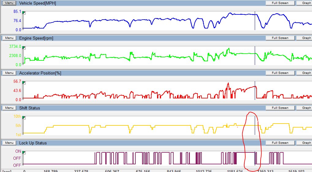

    Change the first 100 on the primary axis to something like 50, but keep your speed value the same and give that a try. FYI 86 in the table is about 75 MPH so you can raise that a little higher if you like.

    Thanks for a tip. Got it working.
    set like this
    TC did unlock at 76.4, accel 43.6 % and RPMS immediately started slowly going up (gained 100 RPMS in 2 sec.
    Looks like a fudge factor is ~1.13
    I may need to lower the 50 value a bit and figure out the locking part to make unlocked a bit longer.
    Thanks.

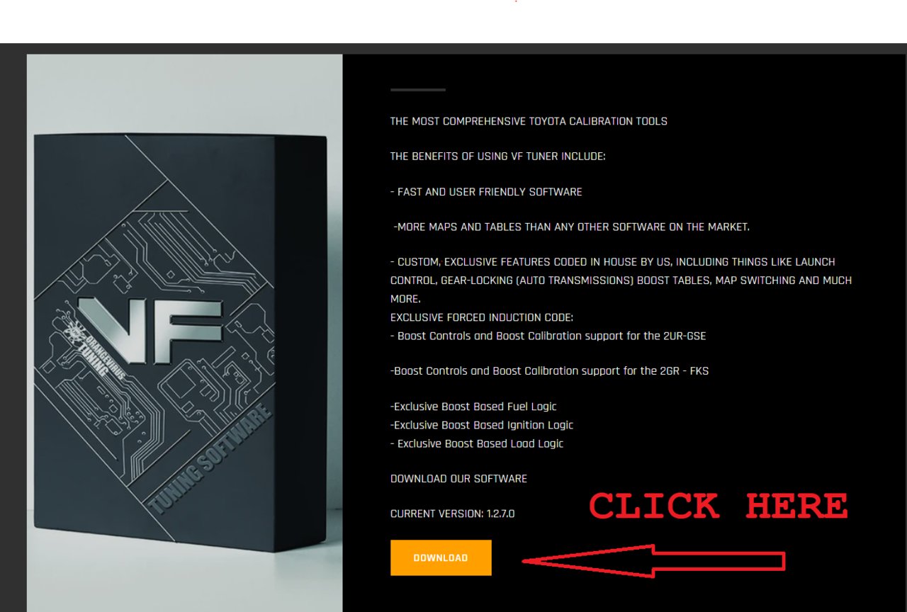

    Anyone able to find the software on the website? I ordered and I received my key. The instructions say to click the yellow button to download it, but the button is for support. I was able to find the old software but not vf tuner

    '17 Sport, ACLB, V6,MT, 04B14 OV-Tuned
    This big yellow download button....? ovtuned.com

    Every link says add to cart

    Found it I did to much clicking and not enough scrolling. I wasn’t logged in

    Make sure you're logged in to your account, then go to the home page.

    Glad you got it. No login needed.

    You don't have to login to download.
    You don't even have to be a customer to download it
