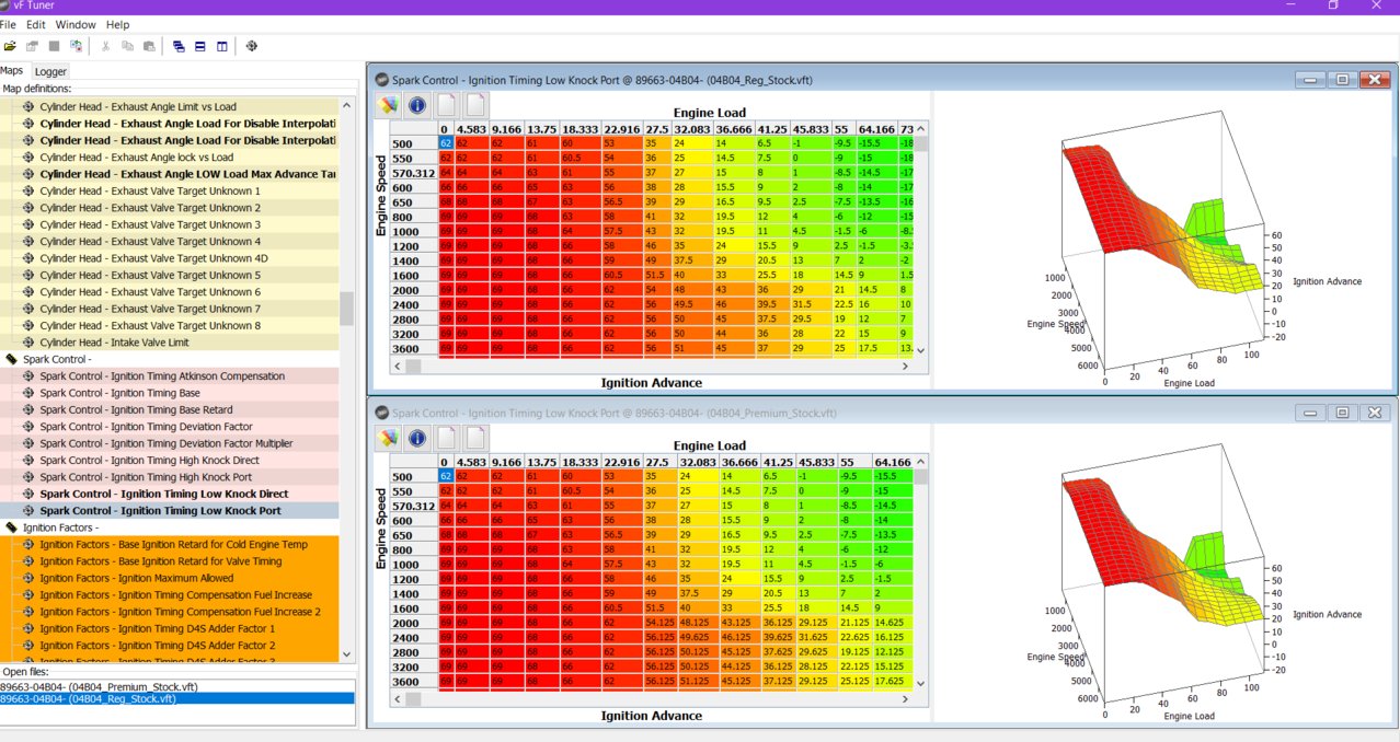

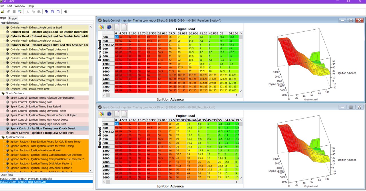

    I just looked, that's not much of a difference. This is Premium vs Stock. Almost exactly the same. Some cells are just 0.125 different.

    Yup that's what I saw. I'd really like to know if there's other changes we can't see.

    There's got to be. Since the tunes are "octane learning", I would think that it is some kind of algorithm that can detect different octanes and adjust? I bet it is a lot more than we think it is due to it being octane learning and not just regular vs premium.

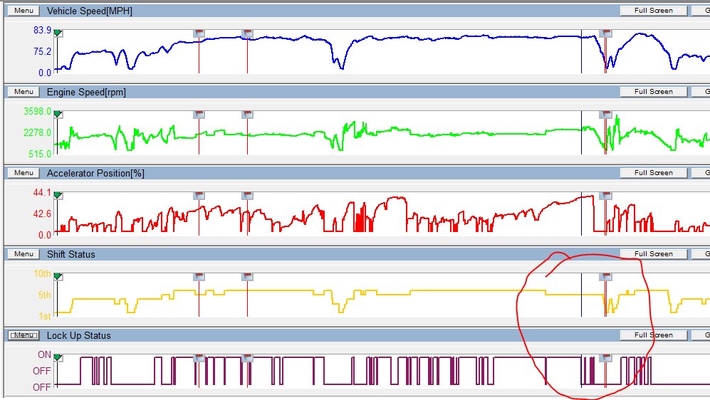

    I did end up copying primary upshift tables and slightly modifying the axis upload_2020-11-13_19-58-39.jpg
    But i was not able to trigger the event on my test drive, because my TC unlock 5th gear is working now and prevents the downshift to 4th. Really helps to keep momentum going on steep and long incline.
    I'm thinking if I can driver to the pass without using 4th gear.
    Now I'm looking at TC lock 5th and my data from the drive. I see that I'm unlocking at 75.2 mph and accel 42.6 and locking at 75.8 mph and accel 43.2. I'd to keep it unlock for a bit longer, perhaps to 77 mph, but the locking table looks off. upload_2020-11-13_20-6-39.jpg . There is no the "fudge" factor
    I'll just bump it to 80 for now.
