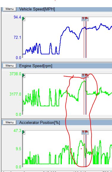

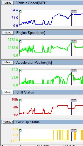

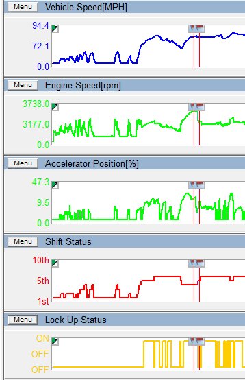

    Got some data for 4 to 5 upshift while climbing up and my numbers did not work. The speed was 71, rpms over 3000, accel 31.6%.
    I started playing with pedal and forced upshift at accel 9.5 and speed 72
    What bothers me that RPMS are not dropping when accelerator is trending down
    I'm going to lower numbers in 27 to 50 by 10 and see if it makes any difference

    Tune: Nexus +P Add ons: +3" custom suspension 295/70/18 Yokohama M/T Tires KMC XD Grenade OR wheels KN intake Blackhawk MBRP Exhaust TJM Rock Crawler Bumper Lighting (+10 H.P.)
    Lowering locked values will make it lock up sooner, yes

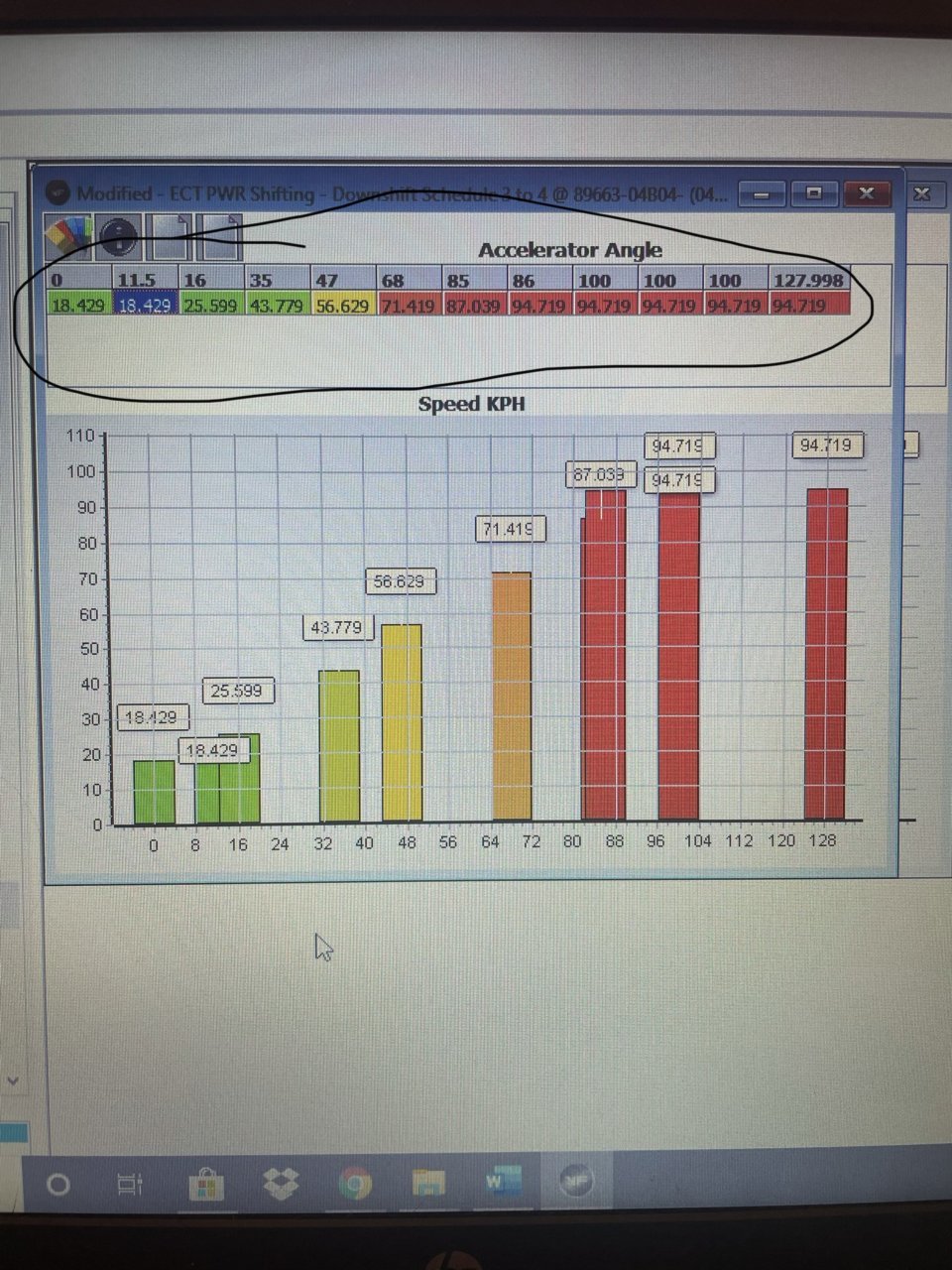

    I have the stock 2.0 flash on the truck. How do I go about adding gearlock to the tune? Or is that rolling out soon?
    Thanks for the help! Really impressed with the performance of the truck already, it really is incredible how different the truck feels. Maybe it’s just a placebo.

    Go into ECT PWR Shifting make the values for each downshift map the lowest value that is in that map

    Got it... so in this photo, just make the circled values all read 18.429?

    You'll have better results if you make each ECT map to the lowest value of the corresponding primary map
