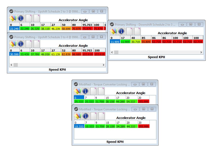

    educate me on the relationship (s) between "primary Upshifting" and correlating "ECT Upshifting" maps. So I like a "TUNE" that provides power, performance. refined and expected shifting points, extra zip with ECT mode and S mode to make towing an option without reservation. I have used the "compare" function to determine differences between tunes - but so far it comes down to relationships, ratios and simple preferences. HELP! And BTW - GL is not what I am looking to utilize as a solution.
    @Mooseditty17 @PapaRee @Stormpeacock @OVTune
  2. Nov 15, 2020 at 5:28 PM
    #7942
    OVTune
    OVTune Well-Known Member
    Mar 27, 2017
    #214557
    8,112
    OVTune
    Primary upshift/downshift tables are used in most conditions (D, 4H D, etc)
    ECT shift maps are used when you press the ECT button.
    Mooseditty17 likes this.
  3. Nov 15, 2020 at 5:35 PM
    #7943
    GoldenBrew
    GoldenBrew Insufficient Privilege
    Dec 18, 2016
    #205159
    2,758
    Golden, Colorado
    Gen3 4X4 TRD OR AT - SOLD not Forgotten
    I understand how ECT engages and works - just not sure when comparing ECT to Primary shifting modes how you maximize power and performance utilizing ALL gears in s mode v.s. without eliminating higher gears in s mode. ??
  4. Nov 15, 2020 at 5:36 PM
    #7944
    OVTune
    Mar 27, 2017
    #214557
    8,112
    OVTune
    S mode uses "primary shift" tables.

  6. Nov 15, 2020 at 5:46 PM
    #7946
    Mooseditty17
    Mooseditty17 Seasoned Rookie
    Apr 7, 2019
    #289395
    1,681
    AJ
    WI
    2017 TRD OR : M+W Nexus Tuned
    Tune: Nexus +P Add ons: +3" custom suspension 295/70/18 Yokohama M/T Tires KMC XD Grenade OR wheels KN intake Blackhawk MBRP Exhaust TJM Rock Crawler Bumper Lighting (+10 H.P.)
    If you are not utilizing gear lock with ECT power: Your S Mode shift points will be the same as your primary shift points with the exception that whatever gear you choose in S Mode is the highest gear the truck will shift into until you tell it. It will however downshift as it sees fit according to your primary shift tables. the reason why you're thinking Smode is gear lock is because once you depress the ECT power button it overrides the primary maps. You are not activating maps by switching to S Mode, you are just now controlling the ECT maps with the "manual" shifting.
    GoldenBrew[QUOTED] likes this.

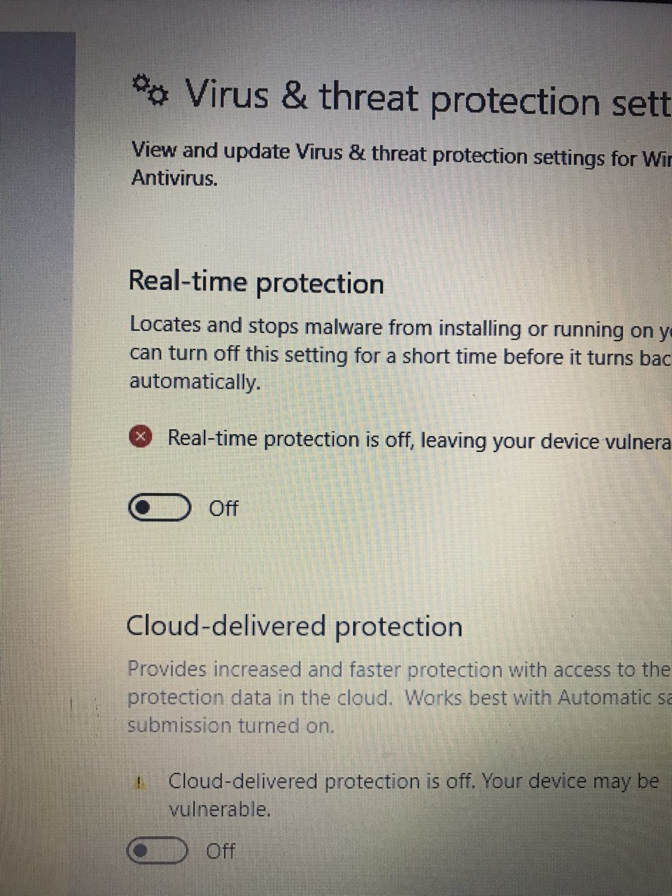

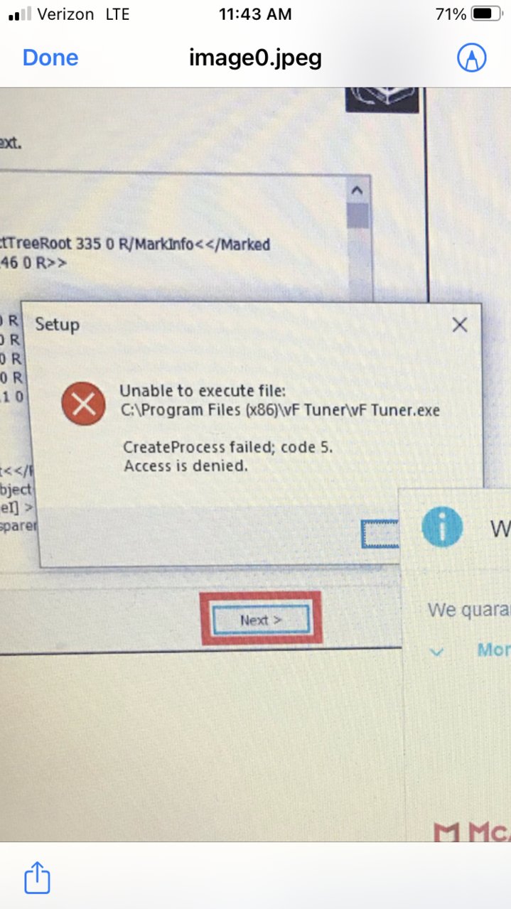

  8. Nov 15, 2020 at 6:08 PM
    #7948
    Jbrentb
    Jbrentb Well-Known Member
    Dec 8, 2017
    #238020
    238
    Jake
    Wilmington NC
    Black 2016 Trd OR Dcsb
    17x9 mayhem prodigy’s with -6 offset duratrac 265/65-17, fox2.5 coil overs, fox 2.0 rear shocks, OME uca, custom vf tune, Urd spec-u exhaust, high flow catted dump tubes, mbrp muffler, S&B cai, Green lane off road skid and stump bumper, ss3 fogs, pro grill and tail lights, tint, led interior reverse and plate lights, bhlm retrofit HID headlights, Meso turn signals, gashole, and coin holder. hardtop on bed and mat. Blacked out meso everything!!!
    Ok so noob here with tuning, I’m trying to download the vf tuner from @OVTune home page “yellow download button” go there the steps and before I get to the registration step I get this message and can’t go any on and won’t load.
    Any help guys thanks!
  9. Nov 15, 2020 at 7:19 PM
    #7949
    GoldenBrew
    Dec 18, 2016
    #205159
    2,758
    Golden, Colorado
    disable ALL Windows OS virus software - including App, firewall, cloud,..... The new MS update made another shit storm.
  10. Nov 15, 2020 at 7:26 PM
    #7950
    Jbrentb
    Dec 8, 2017
    #238020
    238
    Jake

  11. Nov 15, 2020 at 7:30 PM
    #7951
    GoldenBrew
    Dec 18, 2016
    #205159
    2,758
    Golden, Colorado
    After spending many hours comparing your most recent (yesterday) performance_tow tune (with S 6 disabled) to an October release of performance_tow_extra_tip-in I found subtle differences (except for noted s mode 6th disable). I like the most recent because of tip-in but want to opt for enable of s mode 6th (don't ask why). I am / was looking for a scientific reason / method to relate the non-existing data for S mode upshift 5/6 as compared to Primary Shifting upshift 5/6 thinking that was the answer to re-able S mode (w/ect enabled) 5/6 upshift. Duh. More coffee.
    Mooseditty17[QUOTED] likes this.
  12. Nov 15, 2020 at 7:31 PM
    #7952
    GoldenBrew
    Dec 18, 2016
    #205159
    2,758
    Golden, Colorado
    Look in the virus app section - disable all of them (Virus, firewall, app) - everything including all sub-topic items ( screen view...).
    Note: once you get it to load you can run the editing software - but to flash to your truck you will have to disable all noted MS Windows Security features, and remember to use the USB 2.0 port on your computer when flashing as USB 3.0 may cause a fail.
  13. Nov 15, 2020 at 7:37 PM
    #7953
    Vlady
    Vlady Well-Known Member
    Dec 20, 2017
    #238986
    4,619
    Issy, WA
    2017 White SR5 DCSB V6 4x4
    Add that folder to the exception on Windows firewall settings.
    Dont need to disable anything
  14. Nov 15, 2020 at 7:42 PM
    #7954
    ForceOfG
    ForceOfG Well-Known Member
    Apr 20, 2018
    #251122
    154
    Portland, OR
    16' DCLB 4x4 Off-Road
    5.29 Yukons Stage 2 Icons 265/70/17 OVTuned
    It'll upshift to 4 at round about 29MPH with 6% throttle. And assuming the very bottom table is the unlock map, 21 in the cell isnt 21 MPH. Try something closer to 23.8 then your short story should work.
    One thing I'm starting to notice is that it may actually be throttle % being used by the table, not pedal %... Just a theory but it sort of seems that way.. Reason being is that pedal % can be up to about 5% before the throttle % actual starts to go above 0. So i can have 3% pedal and 0% throttle. The TC unlocks when this happens, as if my foot is off the pedal, but its not.

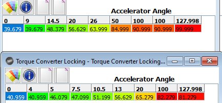

  16. Nov 15, 2020 at 8:48 PM
    #7956
    Vlady
    Dec 20, 2017
    #238986
    4,619
    Issy, WA
    Question,
    do we really have to have 100 and 127 values in locking/unlocking tables?
    The accelerator or throttle dont even go more than 51 % (in least in my case). So if I set 55 for accel as a max, do I need to apply these to other gear tables? I saw that some folks expanded the axis. Do we need to apply the same # of cells to other gear tables?

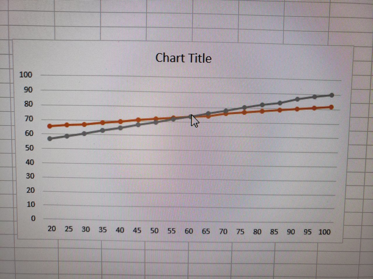

  17. Nov 15, 2020 at 9:29 PM
    #7957
    Vlady
    Dec 20, 2017
    #238986
    4,619
    Issy, WA
    I think i see why was not getting lock/unlock working in 5th gear between 70 and 80 mph and accel 30 to 40.
    I did interpolate 5th gear tables from value 20 to 100 and got this. Orange is tc locking speeds.
    I'm a few Lucille's down, so locking at higher speeds and unlocking at lower or vice versa?

    BlkTaco47
    BlkTaco47 Unhinged
    Apr 9, 2011
    #54635
    5,113
    2018 TRD PRO Midnight Black Metallic
    this^^^ never had to disable anything in nearly 4 yrs of downloading/installing tunes or the software
