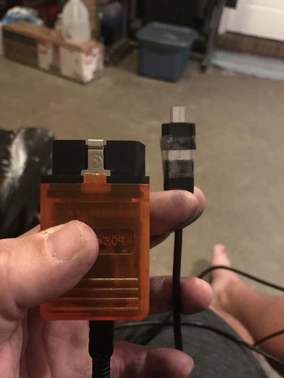

    Will this work?
    ive got an adapter.
  16. Nov 16, 2020 at 4:44 PM

    ??? so you don't have the OBD connector and micro usb cable (goes between the OBD connector and the USB port on the computer). Anyway you cut it what you show the answer is NO. OVTune will send you the ODB device and cable - you download the software and follow the instructions. No cart before the horse.

    I’ve got my software installed and have sent out my system ID to Matt. I don’t have a laptop but a Samsung tablet/laptop “that I’ve already downloaded all software on and just waiting to hear back from ovtune”
    My question is with this computer I’ve got to use a adapter so it will plug-in.
    Do we kno if this will work?

    If you got to the point of sending you System ID, then that is as working as you get at the moment.
    If you are an MT, you would want to do the TSB flash with TechStream to get to 04B14.
    If you are an AT, you would want to do the TSB flash with TechStream to get to 04B04.
    Those are the latest ECU IDs for the 2017s.

    So here you go opening up for more questions, how do I do the techstream tbs flash to 04B04? And thank you for the response!
