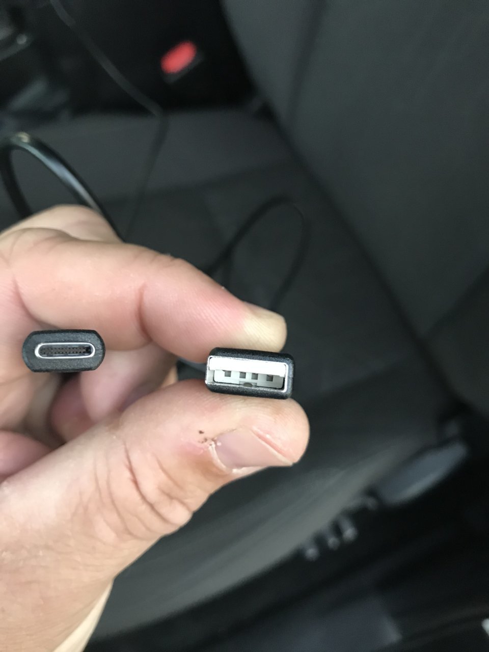

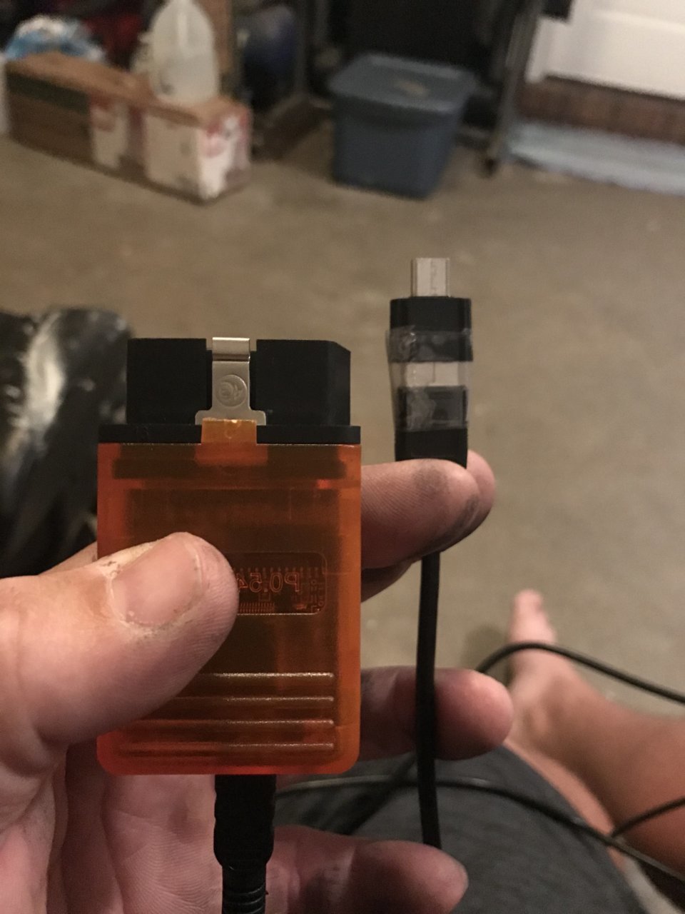

    ?? only way to know if the adapter / computer connection will work is to go a head and give it a try - you will need to do this to identify your ecu. Plug adapter into computer and obd device to your truck's obd connector - be sure to (with foot off brake and be sure all devices such as radio fan,... are off) then press the start button twice (electronics on and engine off mode) then identify button on software screen - that will show you your ecu id. if that works then you are golden for vFTuner, and completing the registration process. GL.

    If the adapter does not work, then you might need to use a USB C universal docking station. They are relatively inexpensive on Amazon or Best Buy. I use them a lot since ultralight laptops don’t have many ports these days.
