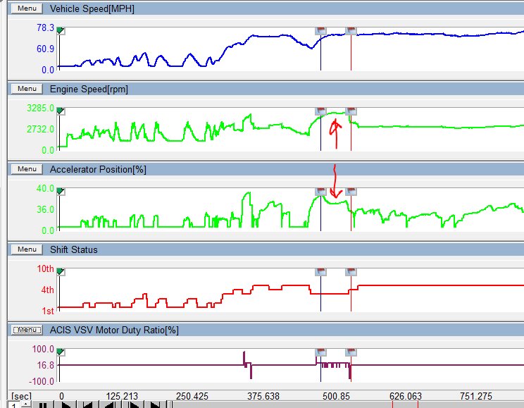

    How much time has elapsed between the two flags in your log screenshot?
    Shifting for me does seem to lag behind accelerator input bad at times. I would also like to change this if possible.

    Almost a minute - 50 sec.

    Oh I was talking much shorter timescales. Different issues. Good luck
