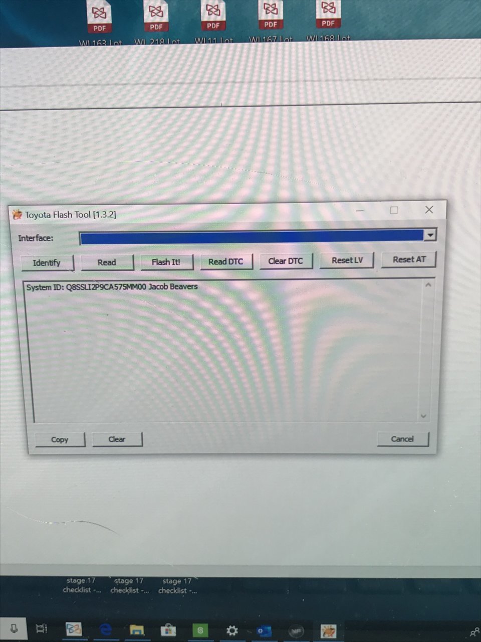

    In the blue section “Interface” is there supposed to be something in that section?

    Yea, pretty sure it should say something about tactrix there.

    Should say tactrix open port. Typically that means you haven’t installed the drivers
