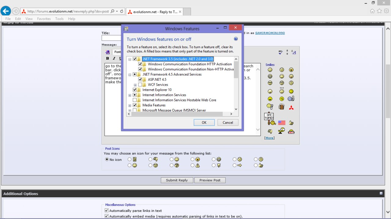

    ktbell444
    ktbell444 One who throws exceptions
    Aug 8, 2017
    #226306
    2,969
    ᚺᛖᛚᚺᛖᛁᛗ
    Check to make sure .Net framework 3.5 is enabled, just as the attached image is.NETframework guide.jpg
    tonered likes this.
