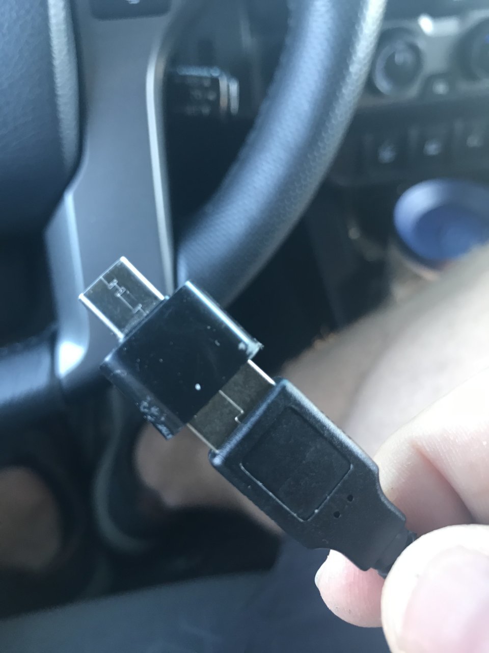

    Even though the ob2 will light up either way, plugged into truck vs laptop. It’s just gotta be something simple I’m missing! That or I just f****** up my work’s computer. Lol

    So, you just have a USB C port on the Samsung tablet?
    How are you connecting the OVT / Tactrix adapter?

    I think it will. I have a guess that adapter is for charging only, not data?
    With that adapter, can you use any other USB cable (not the OVT / Tractrix USB A to miniUSB) and transfer a file to any other device?

    like I’ve stated a few times before I’m not in the tuning game or laptop/computers. I’ve grown up with a cell my whole life. But all this is new. I’m gonna try to send something from my phone to tablet. I’m thinking this is the problem.

    That's all right! We're all new to this until we aren't. I got caught out with charging versus data adapters before.

    :smack: Let’s hope this is my issues. Thanks for all the help/Suggestions guys! I appreciate y’all. :bowdown:

    That is not going to cause the drivers not to recognize as far as I'm concerned.
    The issue i had when mine was blank was that during the driver install right at the beginning it ask if you are sure you wish to install.
    The default highlighted answer is no....
    If you don't click yes then it says complete, but it's not.
    Verify that you did hit the yes button (it's not actually yes, but it is yes)
    Jbrentb[QUOTED] and tonered like this.

    If it was the first time for the Tactrix connection, then it could be blank as the Flash Tool has no idea what drivers mesh up.
    Great suggestion though.
