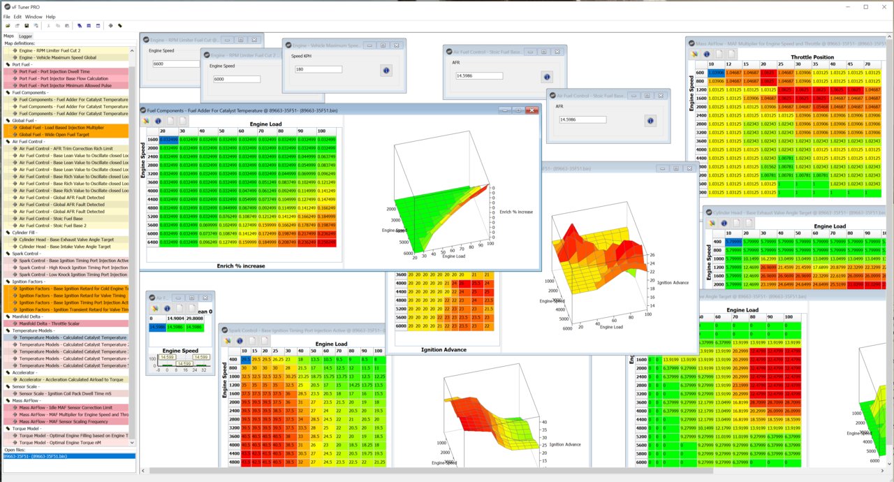

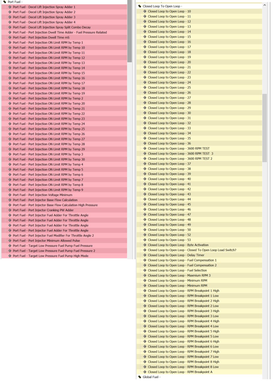

  20. Nov 21, 2020 at 7:50 PM
    #8260
    OVTune
    OVTune Well-Known Member
    Mar 27, 2017
    #214557
    8,112
    OVTune
    Some Tables you guys will be getting in an extensive map update (Tacoma 3.5L)
    (properly named of course)
    BOMBS, ihatemytruck, AbnMP13 and 3 others like this.
