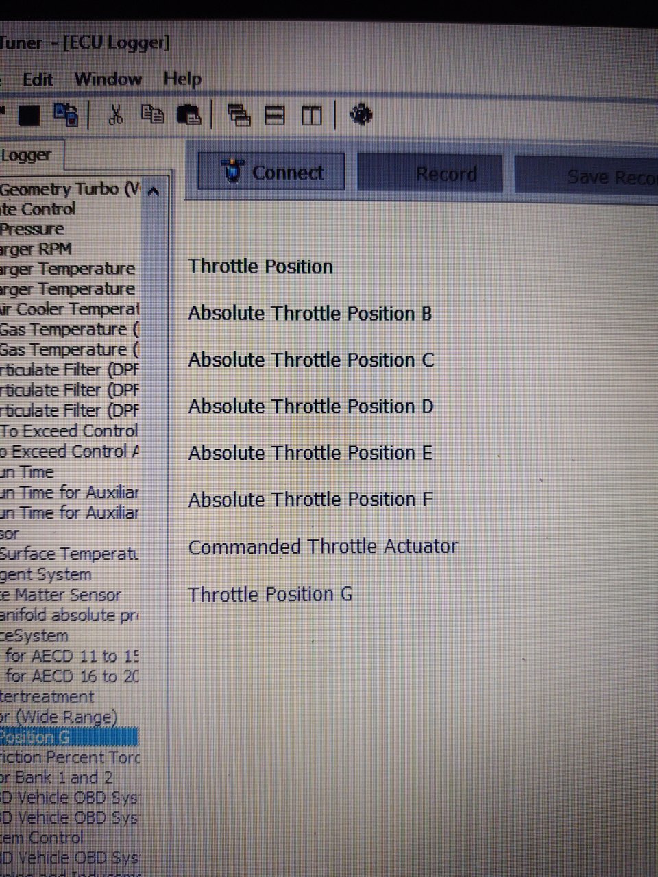

    Which of the throttle positions on the vF logger corresponds to the x axis of the torque converter tables? Is there any fudge factor with this? Will there be TC state logging in the future?

    Great question. I would also really like to know the answer to this for the shift maps.
    Mooseditty17[QUOTED] likes this.

    The axis on torque converter is ACCELERATOR. GAS PEDAL position.

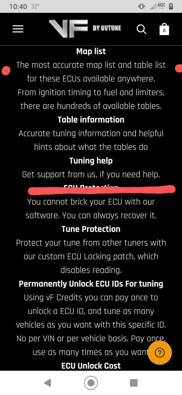

    Asking what the axis values reference shouldn't be considered "personalized assistance." Nobody can fluently operate your software. So until you have a user manual for this months old software that you continue to put off because we are "collaborating with one another as you had intended". AKA, we're figuring it out on our own.... We're gonna have tons of questions. Sorry for being negative today TW, but your answer was super inappropriate! I've literally argued with people about the mislabeled and unintuitive names of maps! Normal throttle limits control ECT power for instance. And until you A: release information on wtf it is we're working with or B answer our "personalized" questions, all we have is intuition.

    Anybody: Where is "ACCELERATOR. GAS PEDAL position" on VF logger?

    If you have some major problem with vF Tuner, or you need something that is missing, need information about a PID. We are happy to oblige.
    But asking us what to set maps to is not the same as correcting / fixing / troubleshooting / etc.
    The snarky comments are totally uncalled for. Nobody is forcing you to use vF Tuner.

    Consider updating your website...
