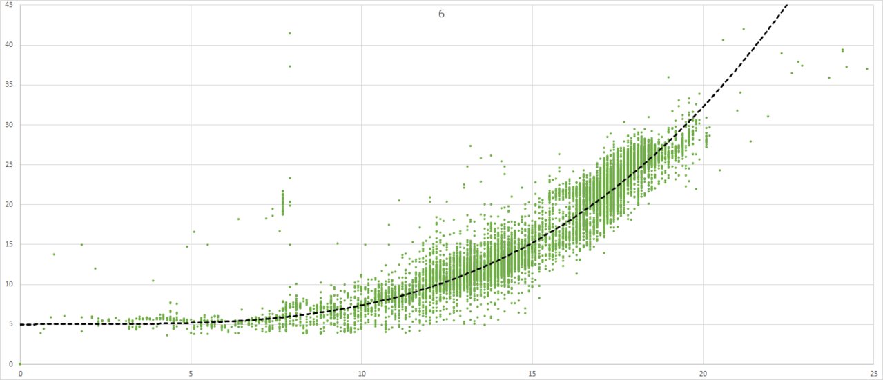

    Oh don’t get me wrong I loved the pretty picture. What I find very interesting is the ~3 discrete curves out past 30% accelerator. Thats got to be part of why this truck is unpredictable.

    I think it is to be expected.
    Consider: you are at relatively low rpm where you can produce little power and you are already at that limit (gear locked to make it easier) if you press the pedal further you are not getting any more power (air) so you will create a trace on the graph going off to the right. (Also, gear shifts take a while; so, there is some data here that shouldn't be. I also need to remember to make sure the AC is off.)
    If you shift at the right time you shouldn't have this phenomenon; but as I said, shift tables are the last thing on my list. I think I can get what I need with this approach. I think I know what to do now to make the truck drive the way I want; but, I am trying to find the most efficient and reproducible way (math and science, not trial and error) to get to the end result... since I will inevitably need to change something later and have to start back at the beginning.
    Here is what I have for 6th to give you more faith...
