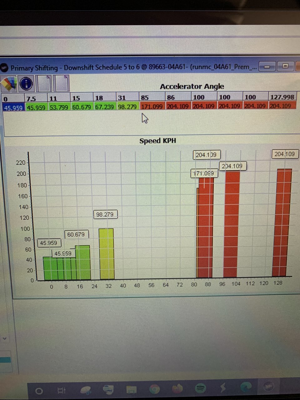

    I have been getting good results by increasing the min downshift speeds at approximately 0-20% pedal and decreasing the downshift speeds at about 20-50%.

    So on this table for example which is downshift 5-6 you’re saying increase the speeds for the first 4 cells then decrease cells 5 and 6?

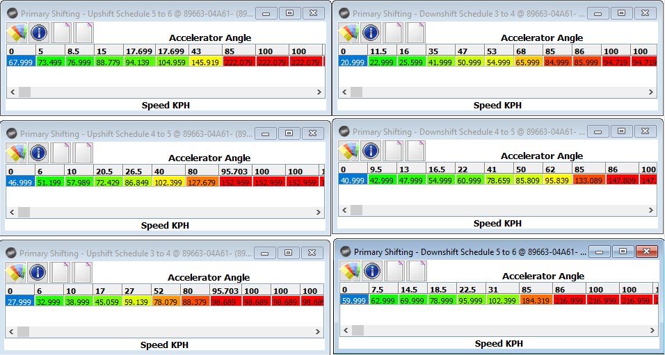

    Here are my current up and downshift schedules for the highway gears. All of my primary shifting and acceleration shifting tables match identically. For the most part I am experiencing smooth and predictable shifts because I am operating the truck in the power band. I am still making small changes by increasing minimum speeds at low pedal, and decreasing speeds at moderate pedal. They are a pretty big change from stock / 2.0, but everyone knows this truck has nothing to give at less than 1500 rpm. I see no point in even trying to operate there for the most part. For mileage I am averaging about 20.5 mpg, mixed city and highway, and I am not scared of giving it the beans, either.

    I compared them to mine and they are only off a few +/- on all tables. I wonder if matching my Acceleration tables would help do the trick. Mine are still stock 2.0
    Also I noticed that my 4-5 and 5-6 tables for Acceleration Downshift and Upshift tables are maxed out to 255.999. Not sure if I need to change those to match my Primary Tables or leave them as they are.
