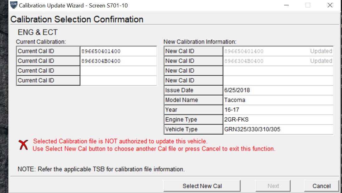

    Now I have another issue, I've got the TSB update done using techstream. I'm now on 89663-04B04, but when I go to flash Mooseditty newest file I'm getting an unsuccessful identification. Battery is hooked to a running car and it's saying batter is at 13.5v could the voltage too high be an issue?

    #172601
    5,978
    Dave
    Did you confirm that your now on 04B04 with techstream?

    Did you start the truck after applying the TSB?

    i have not started truck yet

    Had this happen to me twice tuning other trucks but they both had bad batteries!If you can verify your on 04B04 with techstream then you can go ahead and flash a 04B04 tune. That is what i did. But confirm your ECU with techstream first!

    I think you need to start it, then turn it off, then go through the same procedure for the tune.

    You should start the truck as PhogDog has posted.

    Thanks. Starting truck and turning it off is what it was.
