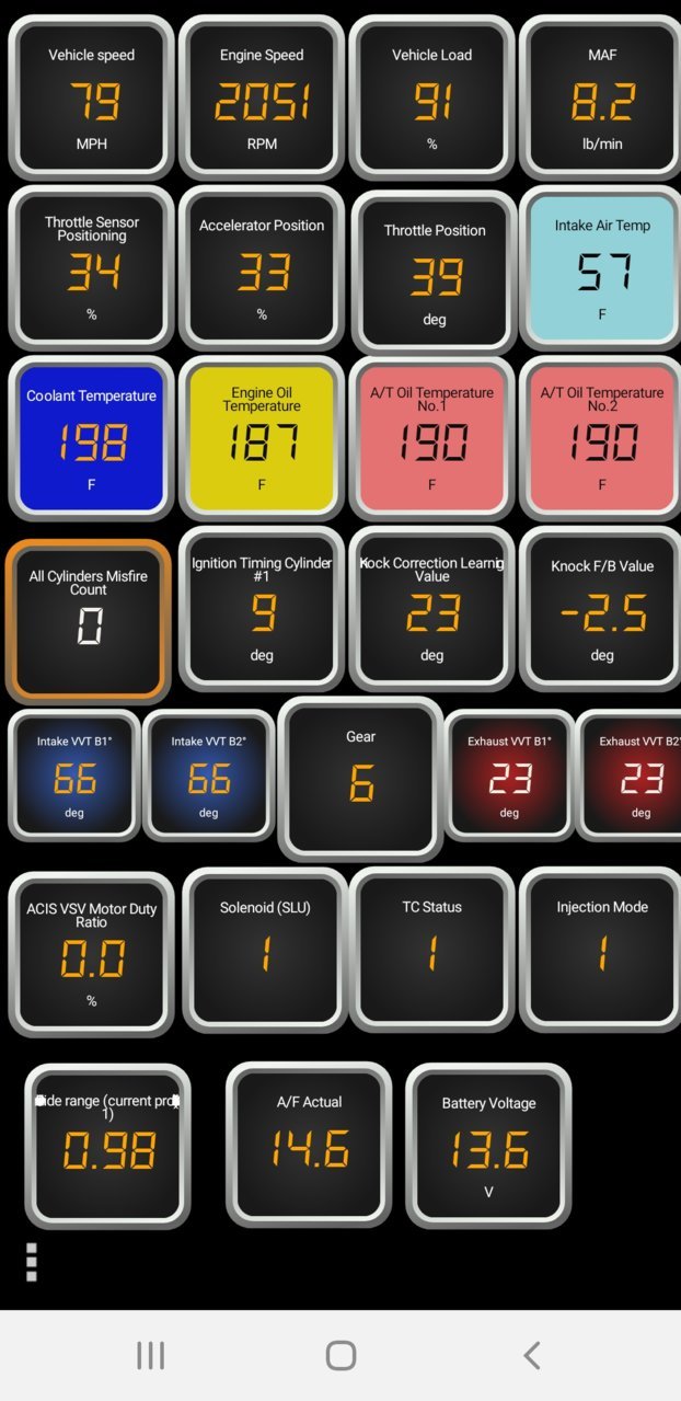

    Yeah, something is off. Looks like you either hitting a max engine load (airload tables?) or downshift points (unlikely).
    I just went to a town 15 miles east of me. All steep grades to and from. This is me climbing up Snoqualmie Ridge portion of the trip.
    6 speed doing 80. Still having 600 rpms available.
    I did not drop to 4th on my trip on the freeway.

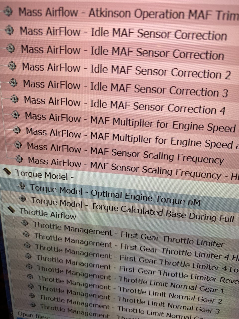

    Anyone play with the torque model - optimal engine torque nm.. yet ?
    Edit- trying to think of another peace of the puzzle to adjust that will change everything even a little more.
